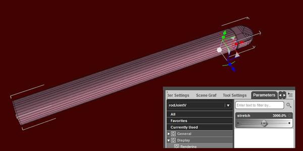

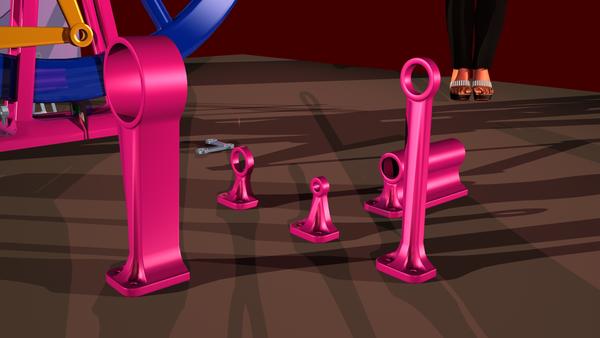

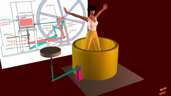

    note that i used a script like that to create the morphs for upcoming free mechanical parts
    i will probably post the script that was used to make the hole diameters morphable

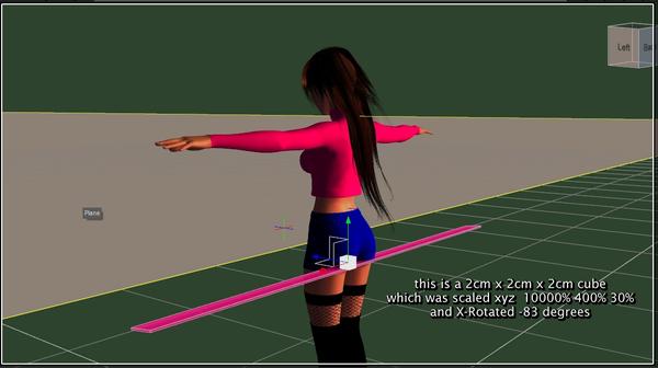

  • mCasualmCasual Posts: 4,607
    a few seconds ago, the thick yellow cylinder was a daz-studio-primitive-torus
    1920 x 1080 - 492K

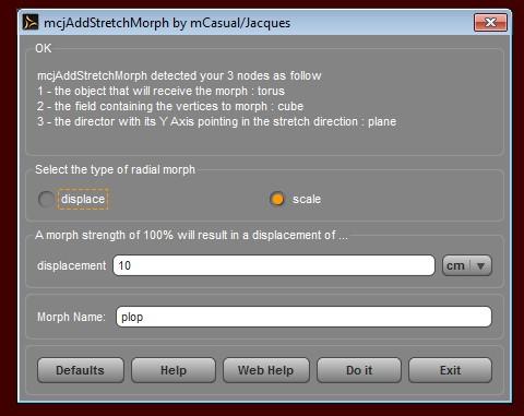

    edited October 2014

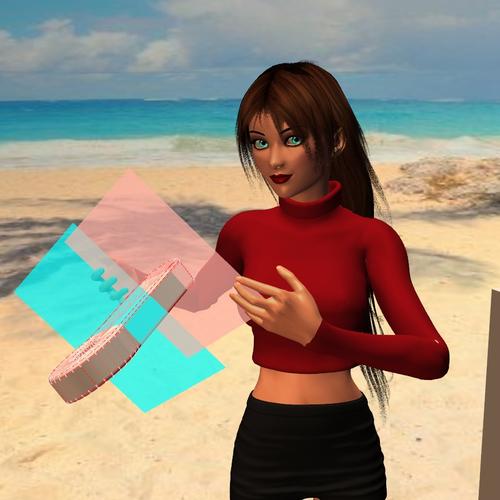

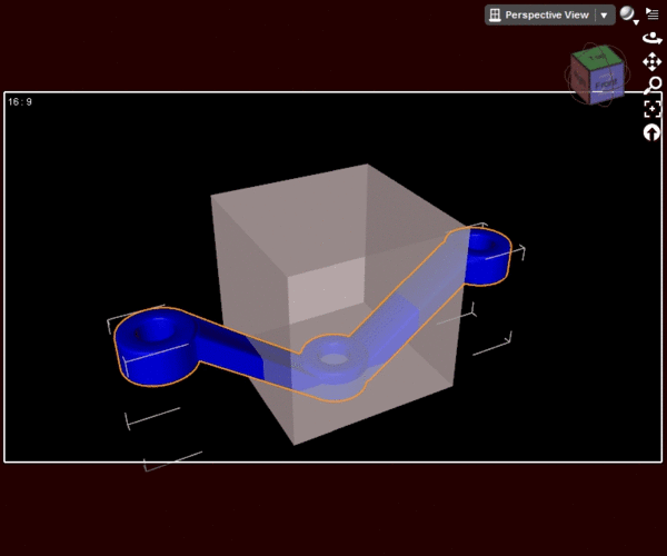

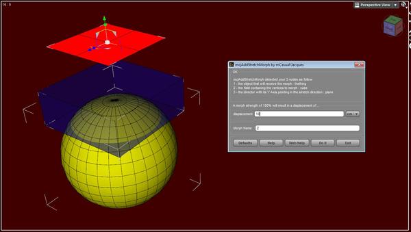

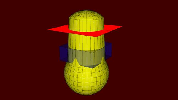

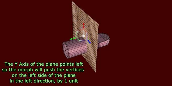

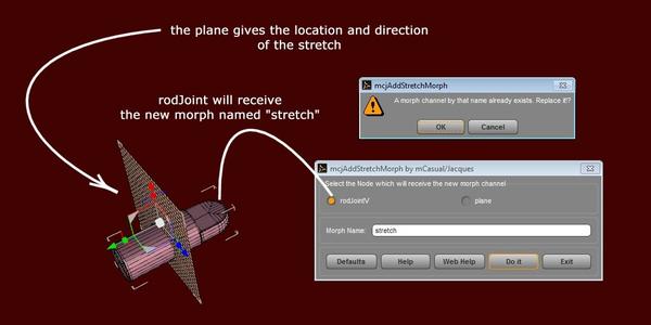

    Figure 2

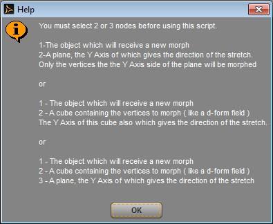

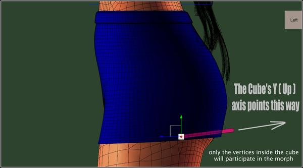

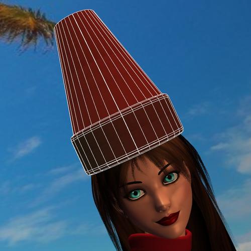

    i will add this feature:
    if instead of a Plane, the "stretch director" is a Cube
    then, only the vertices inside the cube are part of the morph

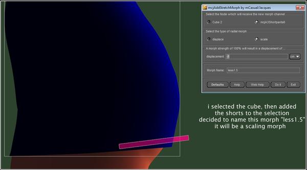

    Figure 3 - a third mode, with a cube to select the vertices to morph and a plane gives the displacement direction
    ( for cases where it would be hard to fit both functions in the cube )
    Figure 4 - when using the 3-objects mode, the script detects the role of each node based on their labels
    No equivocal situations are allowed,
    so your field/domain node label must include the word 'cube',
    your director object label must include the word 'plane'
    and the label of the object that will receive the morph must not include the word 'plane' nor the word 'cube'
    1280 x 720 - 159K

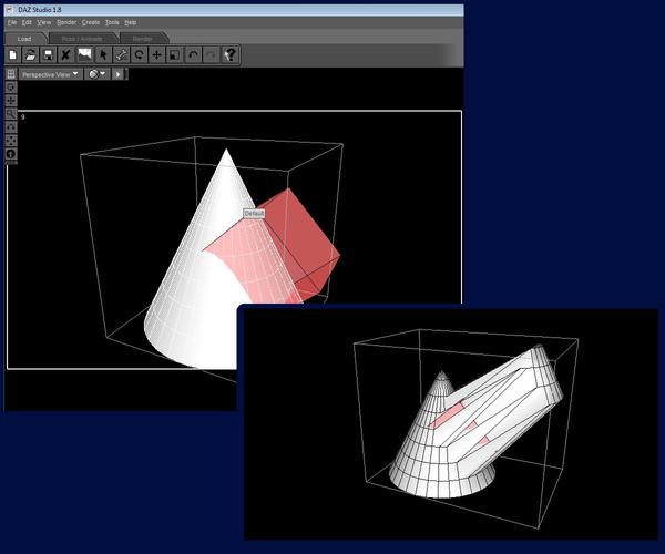

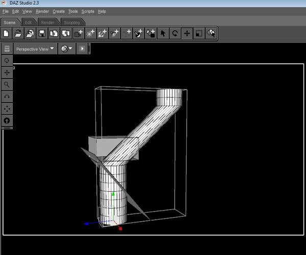

    edited October 2014

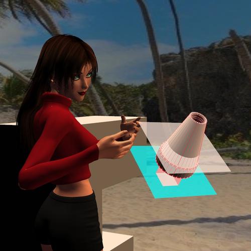

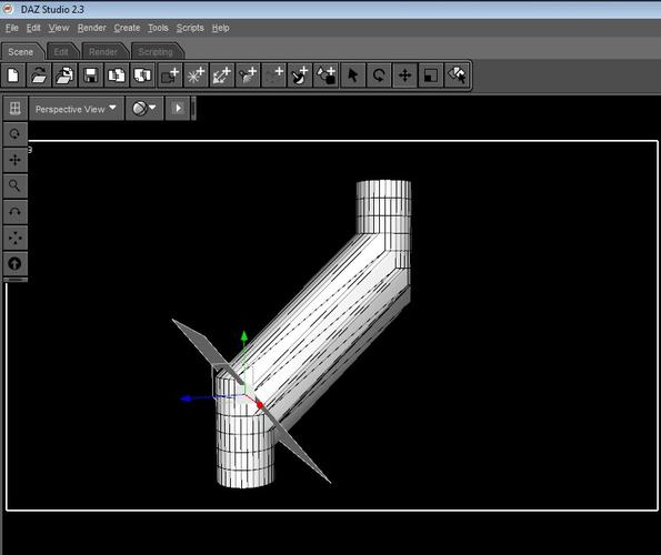

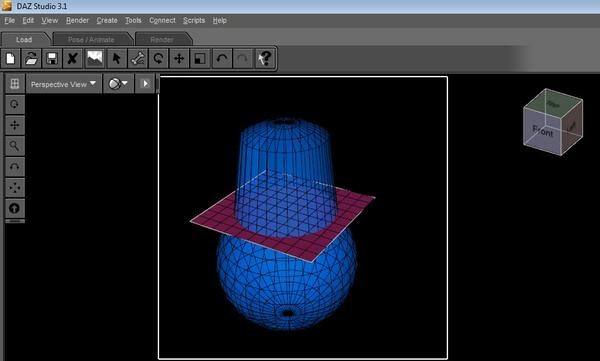

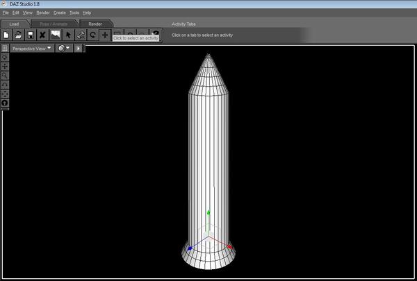

    making little adjustments to make it work in DS 1.8
    a stretched cone
    dang it there's no multMatrixVec function in DS 1.8 ... but there may be an equivalent
    DzVec3 multiply (DzVec3 vec)
    yay it works, it was essential for weirdly rotated and scaled bounding boxes
    works in 2.3 too now
    but notice that the was DS4 displays the local axis is more practical for this
    and it works in DS3.1 without change ( since we only "touch" the vertices and not the faces )

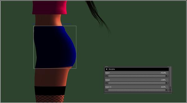

    Miss B said:
    Oh this looks interesting. Even if I don't "need" to stretch a prop, i'll sure have fun playing with it. :coolsmirk:

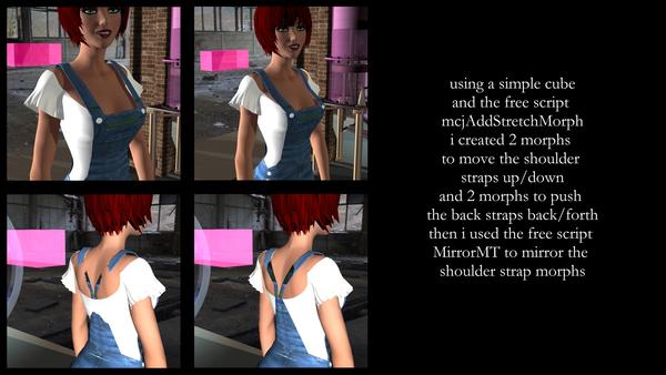

    created a plane
    positioned it across the dress hip section
    selected the dress hip
    selected the plane
    ran the script
    1 second later badabing stretchable dress :)
    900 x 506 - 319K

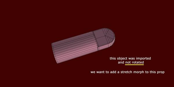

    NOTE:
    For now, before using this script,
    the object that receives the morph must not
    have beeen moved from the position/orientation
    it had when loaded
    Post edited by mCasual on

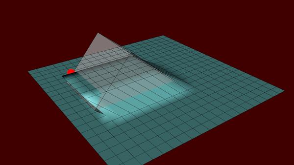

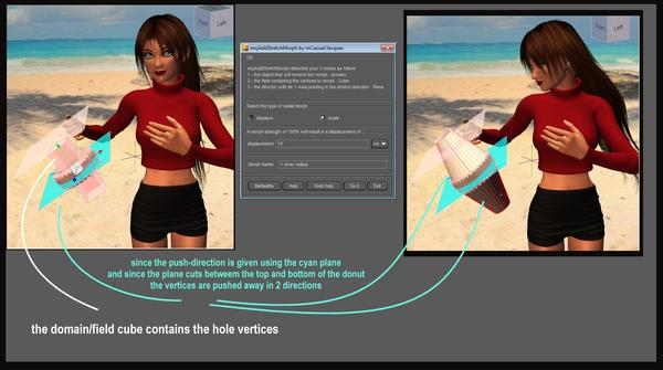

    the update (tomorrow?) will have a
    displace and a scale mode
    and you wont have to zero-pose the object receiving the morph
    because the script will do all the 3d math-acrobatics needed
    1256 x 568 - 98K
    edited October 2014
    the upcoming update will be able to
    add morphs to a rotated/scaled object
    whereas the first version only worked on non-rotated/non-scaled objects
    figure 2, by placing the push-direction plane properly, you will get bi-directional morphs
    figure 3, moved the push-direction plane down, so now all the selected vertices are push-scaled in 1 direction
    900 x 900 - 413K
    900 x 900 - 332K
    1602 x 894 - 239K
    900 x 900 - 374K

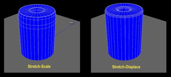

    Update - Version 2 - Update - Version 2 - Update - Version 2 - Update - Version 2 -
    The script now works on props that are not at their initial position and orientation
    There is now a 'scale' option
    instead of just pushing the vertices away as a group,
    the selected vertices positions are scaled.
    if you use a direction-plane, the origin of this magnify effect has its origin at the plane location
    if you only have a domain/field cube, then the bottom of this cube is the origin of the scale effect
    https://sites.google.com/site/mcasualsdazscripts4/mcjaddstretchmorph

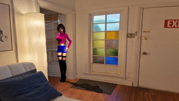

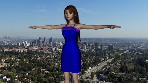

    real-life use, slightly de-cheekifying high waist pants
    hat was done very quickly in the old mcjLathe script
    the OverTheKnee boots for Aiko3 are free on my site

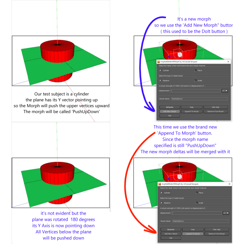

    and there's the "Append To Morph" button which is all explained in the image below
    when it's ready i will post it on the release page , and announce it here

    New in version 3
    If your target object does have a morph named, for example "Stretch" and the current specified morph name is "Stretch"
    then using the "Append To Morph" button will add the selected vertices movements to that existing morph
    then using the "Remove From Morph" button will remove the selected vertices from the existing morph

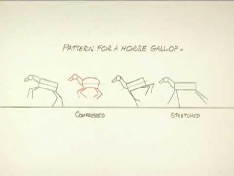

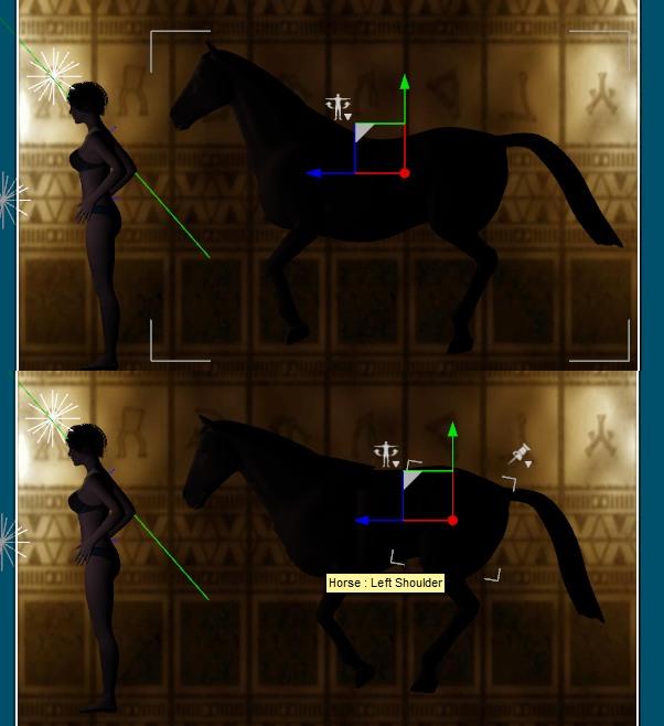

    Hi mCasual, would you say this would do Squash and Squeeze as well, especially to a torso or other body parts, or would that be too much to handle?. Thanks in advance.
    edited March 2019
    you would have to show me visual exanples if what those 2 effects mean, i have other scripts
    https://sites.google.com/site/mcasualsdazscripts4/mcjaddradialmorph
    that create morphs. some allow chosing parts of the object some dont

    This is what I'm trying to achieve, non of the horses enable this from my understanding and without it they look stiff. Thanks
    edited March 2019
    maybe you could Z-Scale the Abdomen and/or chest of the horse using the Z-Scale sliders in the parameters tab
    maybe alo mcjBend could be used to create a better curved-back than the abdomen/chest Bend controls
    https://sites.google.com/site/mcasualsdazscripts2/mcjbend
    mCasual said:
    Sorry for the late response. not sure how to get notifications?
    602 x 658 - 70K
    That should work, perhaps some dforce applied might be possible? Thanks for your input and great scripts.
