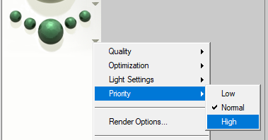

  • Past as FuturePast as Future Posts: 232
    edited September 2025
    No, we've talked about "priority" option in Bryce itself, sorry for confusion.
    On a side note, I wonder if one might check whether or not something could be helped with Process Lasso.
