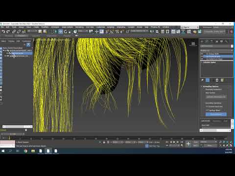

Take a look at this.
Strand hair is light enought to use a cloth sim.
This drove me crazy for ages, I wanted to get strand hair out of daz and into unreal.
Solution that worked for me:
Strand hair can be exported via the third party diffeomorphic plugin that sends daz characters to blender.
In that plugin, the hair is converted to particle hair. The instructions for this are on the authors site.
It takes only a few clicks and in my case a long 2 hours wait, where it seemed like blender had crashed.
Then from blender, The particle hair can be exported as alembic file, then imported into unreal (with Groom alembic input plugin enabled)
as Groom hair. From there bind to your importated DAZ skeletal mesh, setup materials, enable simulation and done.
