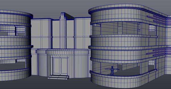

I'd like to get set up as a vendor here, and having second thoughts about how I want to handle geometry. In this hotel, I'm building with subdivision in mind, giving those nice rounded corners, and more believable shapes. But that also means taking time to resolve the extra wires to keep things clean, shape-wise and keeping overall polycount down. These are also things that I could be doing with just a couple of extra bevels on a "normal" model. As it stands, the model renders fine with or without sub-d.
The close-up is the overall density I'm aiming for, overall pretty low, and keeping detail where I need it. It gets a little heavy around the corners. The wide shot is for fun, I haven't given the whole building "the treatment" yet. The final hotel will be inside and out, options to hide each section and all that jazz.
So how about you? Does having heavier set pieces slow things down for you too much? Is this the kind of detail you'd like to see in environment pieces?

  • ToyenToyen Posts: 2,081
    When I read high-poly environment pieces the first thing that came to mind were plants in Vue where a simple grass patch has thousands of polygons so when I wanted to render a meadow full of grass and flowers, I got a friendly reminder that I shouldn´t even try otherwise my laptop would have a heart attack.
    As for your model I think it´s fine having the detail around the edges. After all, there´s really no other way to achieve the smooth shape of the edge, is there? : )
  • frank0314frank0314 Posts: 15,116
    I would say from the pictures you showed you can remove some of the poly unless you plan to do heavy displacement. For something this size it should be around 150,000-200,000. You really don't want to go beyond that. In most cases you don't want to go above 100,000. The lower the poly the easier it is for someone with a lower end computer to render and manage.

    That's the kind of thing I try to be mindful of, since the building won't be the only asset in the scene!
    @Frank, I'm not very experienced with displacement (it's not needed for this piece anyway), is a denser mesh better when going that route? i've never known how the new geometry is created.
    Thanks for the tip on polycount, I'm currently sitting at 14k faces for the whole exterior, there's still more to add/remove.

    I have to admit that, being as I use a program which doesn't handle displacement too well, I like to see modeled in detail. But there again I am quite happy with importing trees which have 300,000+ polys per tree.
    I like to see promos included which show the "clay" untextured model, so it can be seen what the model looks like without textures.

    I don't know enough to know what my direct opinion on poly count should be - whether or not I would suffer more from polygons or displacement and if so how much for either.
    But I do have an indirect opinion: in a set piece like this which has the potential to get very large, go modular. In the images I see what I would prefer to have as 4-6 different props.
    The left, the right, the front fascade / door, and the building behind it. And up to six if the left and right were split by floors. I'm presuming my system would be happier if I loaded in the portions of this that were in camera view for whatever render I did.
    Something no one seems to do but which I would really find nice is that for anything that is an exterior building - releasing it as both high and low polygon (in the same package - I'd be turned off if I was expected to buy the low-poly after having already bought the high-poly). Putting both into the same package would be a nice "selling point."

    I completely agree on modularity, and what you describe is exactly how it is in my scene right now. It all stacks up so you can make it as many stories as needed.
    I come from a gaming-oriented background, I'm used to putting details from the highpoly into a normal map for the lowpoly. I think with DAZ products, I'd rather have a single model, one or the other, but that really depends on what the model is and/or how I made it. A high poly version might need slightly different UV mapping compared to its low poly version, which in turn changes how the texture should be made, for example. -not necessarily worth the effort.
    I've been looking around at what others have made to get a feel for what I should be shooting for, and standard models seem to be the norm rather than subdivision models. So, I think I'll just stick with that.
    edit: @chohole, totally agree with the simple shaded renders!

    What applications are you aiming at? DS supports edge-weighting which reduces the need for bevelling, but Poser doesn't (at this time).

    I always get happy when I see higher res pieces, but that's because my pc can handle it :)
    But for big scenes and in order to reach a broader audience, a lower poly version and modules that can be hidden in parts are always a good idea :D

    Daz Studio. I wasn't aware it did edge weighting, I'll look into that straight away, thanks! That cuts down on the need for some supporting edges in a model for sure.

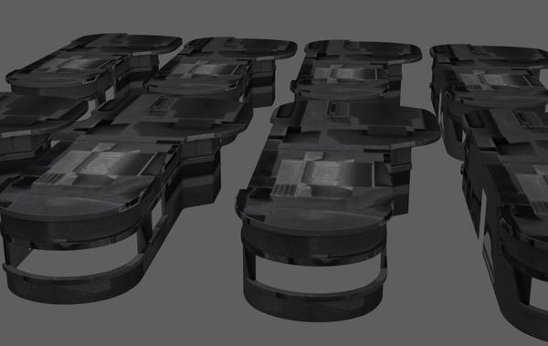

    @FSMCDesigns What sorts of things kill render time? I'd imagine heavy displacement, transparency or ray reflections being the heavyweights here.
    @SereneNight, that's the nice part about working in sub-d, that you can turn it off or on as needed.
    (I can't figure out how to multi-quote, sorry)
    I'm impressed with how well Daz Studio handles sub-d, I did a little brute force test, importing a new copy eight times to make sure there's no instancing, and applied subdivision to each. Mind the random texture grab. At base, each model is 5k faces, and divides out to 75k faces at level 2, the scene is totally navigable. Nothing fancy in the render, took 20 seconds using a spot, distant and UberEnvironment2 at default settings. My computer is an Intel Core2 Duo @ 2.4ghz with 8 gigs RAM - Pretty nice, but not state of the art.
    Sorry if this all seems basic, I'm still trying to get a handle on what a good level of quality vs. performance is in the models. I try to avoid hard edges whenever possible, but that means extra edges to support the shading and/or subdivision.

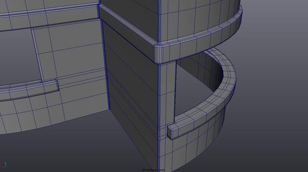

    After spending a little time with edge creasing, I'm sold now. Much fewer support edges are needed, but some still need to be there, depends on what the shape needs. I've never worked with a subdivision surface being the final product, having the majority of the model exist in memory than pure polygons takes a lot off of cpu strain. I worry a little about lower end computers, but I tend to overthink everything.
    I think I'll rework what I've got to suit this new (to me) workflow and see how that works for people.

    I would question if a building of the shape posted even needs sub-d. You may be adding an unnecessary step in your production by using it. Usually with buildings you should just model efficiently and that should be enough. Can't say anything in my store uses sub-d except for things like clothing.

    Perhaps, and it is extra effort, absolutely. One thing I tend to find jarring is when you see a finely rendered photoreal character with hard shading around the corners of things in a backdrop that's relatively close to the camera. For larger city blocks or whole cityscapes, I agree that it's probably overkill.
    Playing more with creasing in this shot just for a quick example. I think I prefer this to regular bevels.
