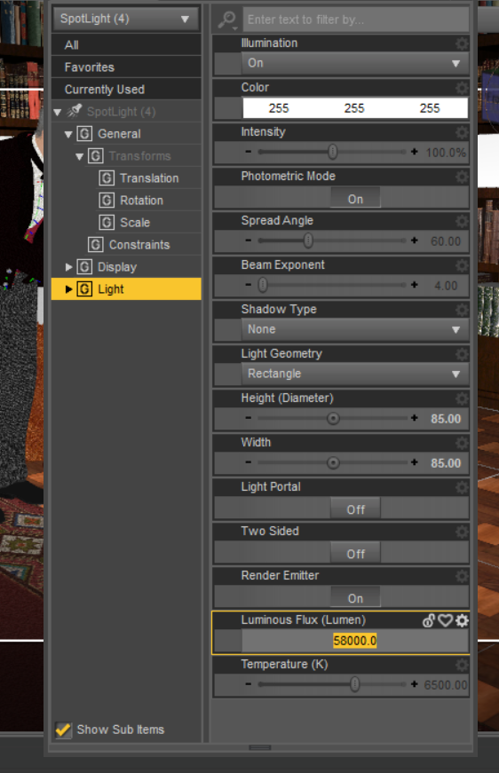

Are you adjsuting the Luminous Flux setting in your lights? you don't mention it in the list above.
I don't touch the intensity slider at all - I change all the intensities using the Luminous Flux slider, almost at the bottom, just above the Temperature.
This is for a fill light, and you can see that I generally find that I increase the setting well above the default 1500 which lights load with.

Yes it's set to "scene only" and yes i tried the Luminous Flux slider. It doesn't seem to do anything.

Ok, i finally got some reaction out of my lights now however i noticed:
1. I had to crank up the lumens much higher than i thought. At about 20.000 - 50.000 noticeable effects started showing. I was playing around mostly around 0 - 15.000.
2. There where light emitting objects in the scene i hadn't noticed yet. Their light interfered extremely with my scene lighting - despite their lumens being a lot lower. When they were on, my lights seemed to do nothing, even at high lumen values. Turning some of them off allowed the lights i had placed to actually do something.
So it seems i didn't notice my scene lights because some light emitting props i hadn't noticed were shining much brighter for some reason. Also at low color temperature cranking up the lumens seems to increase the "coloration" of the scene much more than it does the actual brightness.
