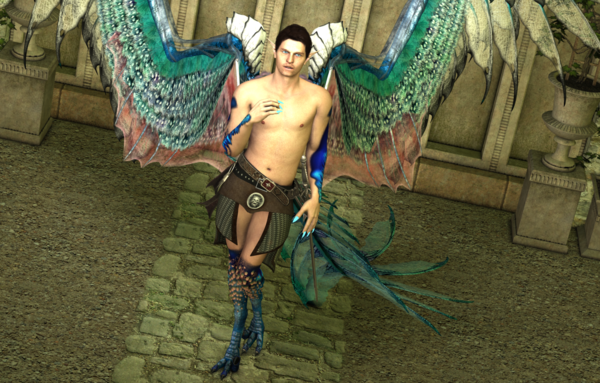

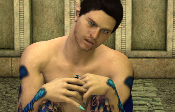

I have put the first image I did below
And then another, where the only difference was that his position changed. The light helper has not been touched...

    Are you referring to why he's a lot less bright in the bottom shot?
  • UpiriumUpirium Posts: 730
    I mean, his facial hair just looks really weird and patchy unlike the first picture. Which, I know, is a lot further away but it still doesn't look RIGHT. It doesn't look even and it seems like it's recent. I haven't had this much trouble in the past with this skin or light set.
    edited September 2014
    The first picture looks a bit patchy as well imo, just harder to spot because it's further away. What texture is the beard from? I can see if I have it and can try it with another light set.
    Also, I don't know if the mats use displacement, but do you have displacement on in your render settings?

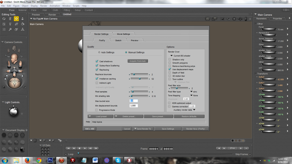

    Can you give a screen shot of your render settings?

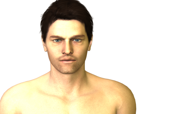

    Idk what you mean by that either because it's...a skin it's kind of just..idk, bumped like a skin. But like I said this is recent and I have rendered him before without this problem. I mean I will show you an earlier pic I did with the exact same skin and render settings and the same light helper with the same light set.
    The difference is it was rendered in PP12 not 14.

    If I understand correctly the last render was done in Pro 2012.
    Do you still have Pro 2012 loaded on your system? If you do, load the scene into Pro 2012, open up the advanced materials tab in the materials room and take a look at the face texture. If necessary, grab a screen shot of the materials room.
    Close Pro 2012. Launch Pro 2014 and load the scene. Open up the materials room and take a look at the face texture. Make a screen grab if necessary. Compare the two. SMS made some changes to the materials room between Pro 2012 and Pro 2014. If this an issue created by the changes, you should see it when you pull up the screen grabs side by side.
    It could also be a lighting issue. What happens if you load the scene, delete the light set up and load a light set that ships with Pro 2014? Do you get the same results?
