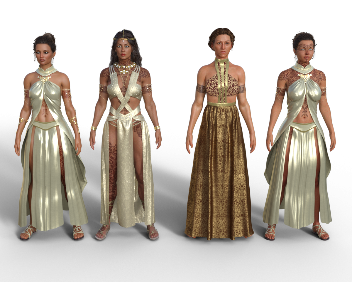

    I don't know the product itself, but maybe you can create an "opacity" map out of the design in an image editor and use it as a Diffuse Overlay Weight (or Makeup Weight if using the new G8.1 shader). Then you can use whatever color and opacity you want directly from the surfaces tab.
  • jukingeojukingeo Posts: 761
    edited February 2021
    Well, since that option still uses an image editor (I use GIMP instead of Photoshop), then it is the same to just change the color and rename the file, which is what I did.   At first I didn't know how to do a global color change in GIMP, but found out how to do it and that was a huge help than just using the fill tool to individually change each element of the tattoo.   So once that was done, I just added RED to the file name.  Then I was just able to use LIE in Daz to sub out the file in the layer and that worked.   However, each portion, head, torso, legs, arms, had a different file, so it was still a bit time consuming, but not bad.  It was at least doable.
    However, I have noticed that the color is affected by other settings on the surfaces tab and I found this odd since it is a layer.   So the red tattoo is not fully red, but still brownish.  Which is not really to my liking when compared to the photo above.   In the attached photo above, compared to the one below, the character is the second one below.   While, it is better than what I started with, I am still not happy with the results.   You can see the varying degrees of how the effect is on this collection of characters:
    As you can see, they are still very brown looking.  The one too the right was so bad though, that I had to change the 'transmitted color' parameter rather than the 'base' parameter to get the tattoos to look more red, but she is the worst one, still looking very brown.  The one on the left came out the best showing the most red.   Yet the layer itself shows VERY red as I have dialed the tint ALL THE WAY to red, when editing the henna layers.  So something else is interacting and I don't know what it is.
    Finally, I would like to make these red tattoos show up when I pull up the Tribal Fury henna tattoos along with the rest of them.  So that is something I don't know how to do as of yet.
    Thanks,
    Geo

  • MelanieLMelanieL Posts: 7,882
    Have you tried (maybe just on one body area as a trial) Hellboy's suggestion? It sounds as if it might preserve the red colour better than the LIE method.
    Yes, I have tried to do it, but it is an over complicated way of doing it as the image has to be inverted and then the arms disappeareed on me.   So unless an easier way presents itself, I am just gong to live with the brownish color.
    It is amazing that somethings the things that you think should be a simple fix, ended up being hugely complex.
    Thanks,
    Geo
