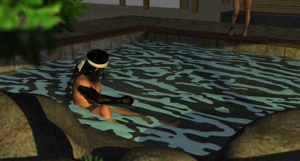

I've been working on a new piece for almost the last month now, and am having a very odd problem with the water when rendering the image.
In the image, I use the Haru Goten set from Hisayan Image Labs for the buildings, ground, and water plane, the Japanese Onsen by Uwe G (with its native water plane's polygons turned off), and the clear water shader from Sickle Yield's Poser/DS conversion of Spacebones' Water Props with a color adjustment to the diffuse color (but no texture map), an added bump and displacement map (with adjustments to the Bump and Displacement settings), and adjustments to the refraction setting (refraction index changed to 1.33)and opacity (the latter changed from 39.8% to 50%), as well as horizontal and vertical tiling changed to 5. The problem, as seen in the attached image (cropped to avoid obvious TOS issues) is these odd milky blue blobs that appear in the render, but not the preview, and not a reflection of anything in the scene. I've already tried a few different options to try and get rid of the problem to no avail. Troubleshooting takes forever because I can't do spot renders with this piece without crashing DAZ Studio, so I have to render in the Stand Alone 3DeLight and it takes a Day and a half to two days to render. Has anyone had this problem before or any ideas on how to fix it?
2000 x 1073 - 477K
Post edited by Tramp Graphics on

    OK, Here are the full settings for the water:
    Diffuse Color: 35 63 47
    Diffuse Strength: 100%
    Glossiness: 90.8%
    Specular Color: 255 255 255
    Specular Strength: 100%
    Multiply Specular through Opacity: On
    Ambient Color: 13 13 13
    Ambient Stength: 50%
    Opacity Strength: 50%
    Bump Strength: 100%
    Bump map: FS Lake water-13 bum.jpg from Fairy World's Fairy Pond.
    Negative Bump: -1.00
    Positive Bump: 1.00
    Displacement Strength: 127%
    Displacement Map: FS Lake water-13 bum.jpg from Fairy World's Fairy Pond.
    Minimum Displacement -1.00
    Maximum Displacement: 1.00
    Reflection Color: 255 255 255
    Reflection Strength: 100%
    Refraction Color: 255 255 255
    Refraction Strength: 100%
    Index of Refraction 1.33
    Horizontal Tiles: 4
    Horizontal Offset: 0
    Vertical Tiles: 4
    Vertical Offset: 0
    Lighting Model: Glossy (Plastic)
    UV Set: Default UVs
    Smooth: ON
    Angle: 89.9
    Render Priority: Normal
    Propagate Priority: Off
    Follow Blend: 100%

    OK, I tried removing the bump map and settings, leaving only the Displacement map (since they're the same anyway) and reduced the reflection to 75% to see if that would solve the problem to no avail. I started a new test render last night before bed, and the render is about 60% done, having just exposed the corner of the pool, and guess what, the "blobs" are still there with no difference whatsoever. So the blobs are definitely not reflections. I'm not sure what else to do except completely replace the water plane.
  • Tramp GraphicsTramp Graphics Posts: 2,435
    edited October 2014
    Well, my latest "test" render finally finished, and the results speak for themselves, the blue blobs are still there. Removing the bump map and bump settings and changing the reflection setting didn't do anything except make the actual reflections fainter. There was no effect on the "blobs" whatsoever. So, either there is a problem with the displacement/bump map I'm using (highly unlikely), or there is a problem with the water plane itself.

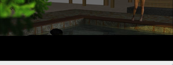

    Anywhat The last render was a bust. While the "blue milk blobs" are gone, 3DeLight crashed a little over halfway through the render, so using the Distant Lands water is out. Back to square one. The reflections and refractions all looked nice though.
    1999 x 756 - 183K
    I don't know what to do anymore. I'm either getting blue blobs, an incomplete render with 3DeLight quitting on me halfway through, or both, If I use a prop water plane, I get the blue blobs, if I use a figure water plain, 3DeLight quits on me halfway through the render.
    It's been a while, had to do my Monster Mash challenge image, which took most of October, and finally got back to trouble-shooting this piece. My latest attempt involved deactivating the large prop water plane that came with the Haru Goten set (since it's mostly not visible anyway) and trying to rely on the Onsen's built in water plane. I also applied a diffuse texture and trans map (both from the Fairy Pond set, which is where my displacement map came from). The good news is the blobs weren't there. The bad news is I'm getting the same render crash as with figure based water planes. This is what I got about 2/3 of the way through the most recent render attempt:
