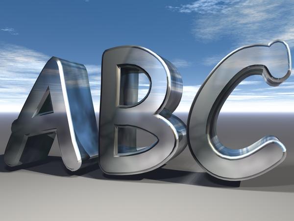

  • srieschsriesch Posts: 4,243
    If you use actual 3D letters with slightly rounded edges and corners, you may get better reflections. I wonder if you could fake it with a displacement on the 2D letters to give them depth? Not sure if that would work or not.
    It is also important that you have an environment around them to actually reflect; reflective materials with nothing reflecting in them, of course, don't look reflective. (or alternately I think you can use a reflection map, although I don't actually know how those work.)

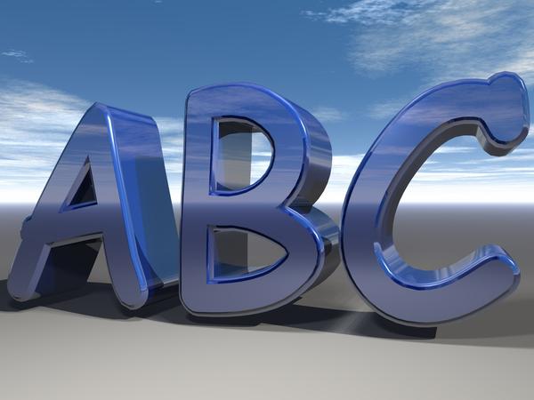

  • carrie58carrie58 Posts: 4,175
    I have 3d Alphabet from Portrait Studio that was a free download ......only I can't remember where I got it ...... but with a gold shader I got this ....
    1042 x 946 - 1M
    Portrait Studio is Structure, over at rendo http://www.renderosity.com/mod/freestuff/?item_id=65872

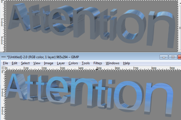

  • TorbyTorby Posts: 250
    edited September 2014

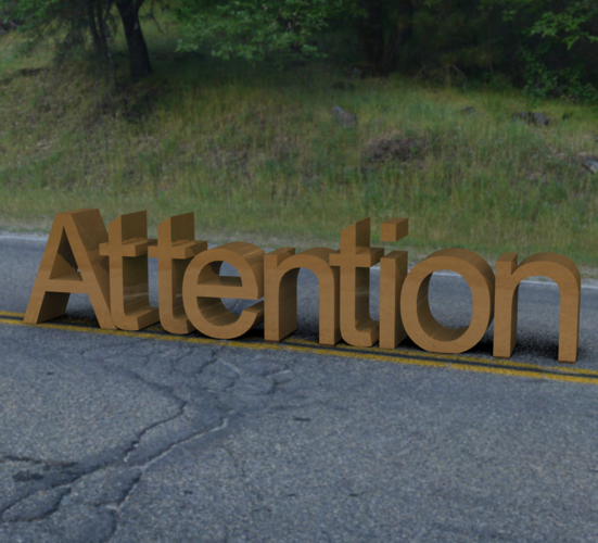

    Oh my. Somebody didn't know much about typography when they made that set :)
    I guess I should have looked closer at the Attention sign above.

    Torby just scale the larger ones to match the smaller or versa visa ..... or scale everyone to a size you like ,that's what I did.

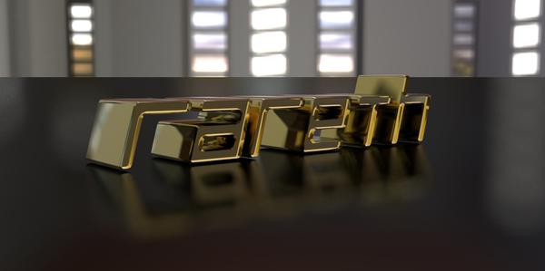

  • RarethRareth Posts: 1,462
    1754 x 875 - 649K

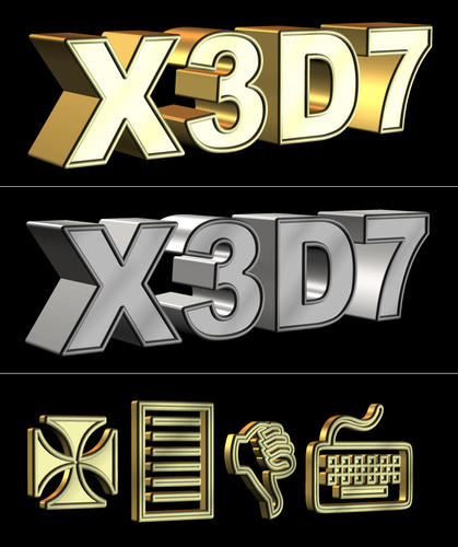

  • TaozTaoz Posts: 10,367
    Xara 3D Maker is specifically designed for this, it has real-time rendering, text animation and a lot of other options and features:
    http://www.xara.com/us/products/xara3d/
    Here's some metal samples:
    814 x 972 - 130K

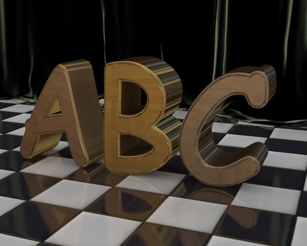

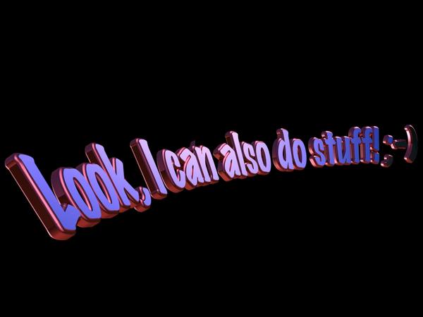

  • Miss BMiss B Posts: 3,071
    I've also done 3D text in Bryce.
    800 x 600 - 449K

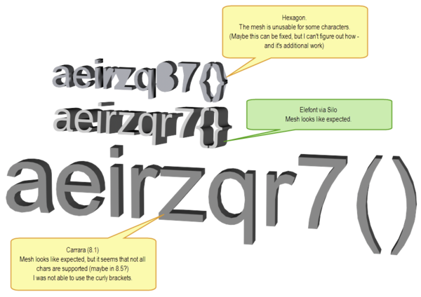

    I got the Elefont program. Aside from Windows being terrified of it, what do you do with the resulting "DXF" file? I tried to import in DS, but the import dialog doesn't list dxf.
    Post edited by Torby on
  • ruekakaruekaka Posts: 348
    edited October 2014
    I got the best results with importing Elefont's dxf file into Silo and export it from there into the format I really need.
    Post edited by ruekaka on
  • robkelkrobkelk Posts: 3,259
    You'll have to convert the file. A couple of options - pick one:
    1) Load it into Bryce, and save it off as a format Daz Studio can read
    2) Use PoseRay to convert it to OBJ

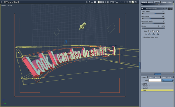

    Thought I'd chime in. I stumbled on this thread last week because I was searching for a way to create an animated 3d title that looked professional. I tried Hexagon, Carrara, and even downloaded the Xara trial. None had all the features I needed. Then I found Corel Motion Studio 3D. Downloaded the trial and it's PERFECT. It comes with tons of already-made animations, awesome lighting that you can animate (the timeline is great), allows you to import your own textures and even to "emboss" those textures (a key feature for my needs). You can import your own background or render with transparency to combine with your own (in my case, animated) background in external video software. I could go on. Anyway, it's not cheap at $70, but I'm getting an early Christmas present!
    M.
    M.
    So, out of those features you listed, what couldn't Carrara do?

    Text functionality would be on a wishlist for the next DAZ version perhaps.

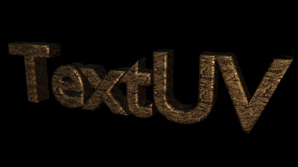

  • ArtiniArtini Posts: 10,920
    edited October 2014
    I have exported letters from Vue as an .obj format and rendered them in Daz Studio 4.6 Pro with ParrotDolphin metal shaders
    from Renderosity. I enclosed scene in the sphere and applied same shader there.
    1280 x 1024 - 194K
    Post edited by Artini on

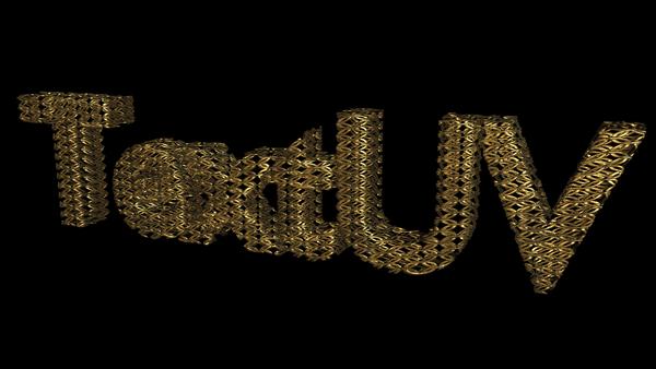

    edited October 2014
    Then, the same meshes I have rendered in Bryce 7 Pro with some of the metallic shaders available in it.
    1280 x 960 - 181K
    1280 x 960 - 185K
