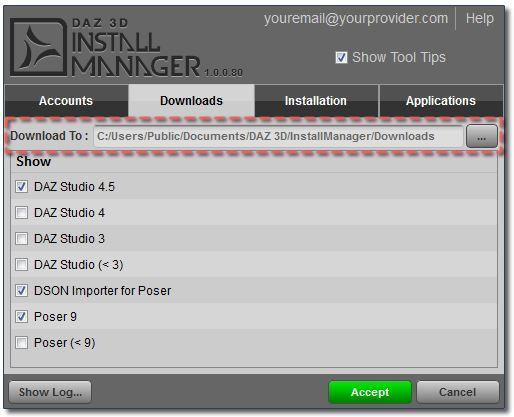

    According to the DIM documentation, this is the default (I don't know for sure that it's still true because I customise all my file locations in DIM and DS.
    By the way the documentation is here: http://docs.daz3d.com/doku.php/public/software/install_manager/userguide/configure_install_manager/tutorials/settings_for_install_manager/start
