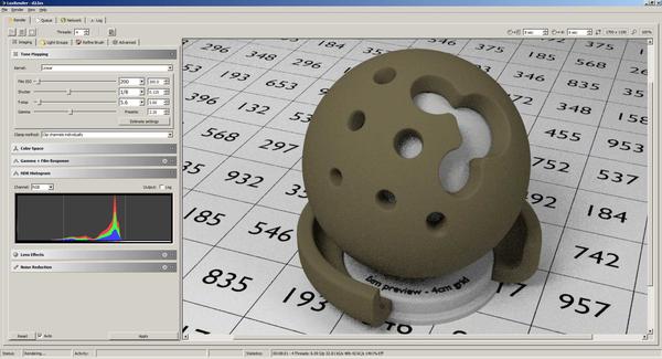

    SpottedKitty, I cannot find the Estimate Settings button under the Tone Mapping section. I have two options there: Kernel and Clamp Method with a drop down menu for each, that's all.
    Ah... <headdesk>
    Sorry, should have asked which Kernel setting you have. Reinhart/Non Linear is I think the default, and it is useful for some things, but I think most Luxus people use Linear for real-world-ish scenes — that's the one that gives you real-world camera settings as if you were looking at the scene through an infinitely programmable SLR camera. And the Estimate Settings button is right below the camera options. Here's what my usual GUI settings look like, running the Luxball test scene for a few minutes. I've used the Estimate button, then changed the Shutter to 1/8 sec. to bring the brightness up a bit.
    Sorry about that, there are so many things to fiddle with in Luxus it's easy to forget one or two that are actually pretty important, if you've never done it before. :red:
    1920 x 1040 - 166K
  • Genevieve LarocheGenevieve Laroche Posts: 33
    No worries at all! You are being very helpful! I found it now, thanks! There is indeed many things to fiddle with in Luxus and it will take me a while to figure them, but I'll achieve to do so.
