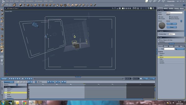

  • Rashad CarterRashad Carter Posts: 1,834
    Thanks for the help to my previous questions. Now I have a new one.
    How does one go about parenting a sphere to the camera such that if the camera moves the sphere follows it? Any help is greatly appreciated. Thanks.
  • JoeMamma2000JoeMamma2000 Posts: 2,615
    edited January 2015
    The easiest way is in the Instances tab, just drag the sphere on top of the Camera, and it will be parented. I do that all the time with lights, parent them to the camera so you have a camera with light, like some real movie cameras. Or like a flash with a still camera.
    And BTW, the XYZ position of the sphere after it's parented can be changed to offset it from the camera location, since all the XYX values are relative to the parent.

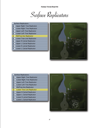

    That is an awful lot of replicators and replications. Are all those replicators in camera view? If your scene is a mile square, there may be ways to optimize the replicators. The higher geometry objects could play a part as well.
    What I do with a large and complex scene like that is to figure out some camera angles that show off key aspects of the landscape/scene. Then I design my replicators around that, keeping in mind, that if this is for other users, they my have entirely different ideas on camera placement., so flexibility is important.

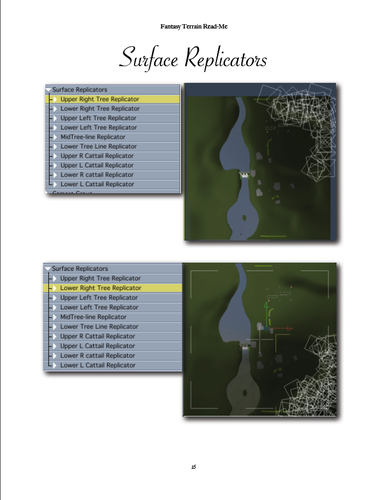

    What do I mean by designing my replicators around the camera angles? A good example is my free Fantasy Village Terrain. It is pretty simple compared to the renders you've been posting, but the same principles could be applied. For the surrounding trees, I basically, I split my scene into rough quadrants, and used the 3D paint tool to paint distribution maps for the individual quadrants (they can overlap a bit). I then inserted four surface replicators and used one for each quadrant, and one of the distribution maps. This allows the user to hide the visibility or reduce the replications of the replicators that are not in view, thus speeding up the grid calculations and lighting calculations if GI is used.
    I also used the same principal for the water plants in the ponds and some extra tree replicators, all for the same purpose. If they're not in view, you can hide them or reduce the number of replications. If the user is making an animation, hiding and unhiding create keyframes, so the user could hide a replicator when off frame and unhide it as the camera moves that way.
    Following are some illustration from the manual that I included with the Fantasy Village Terrain.
    720 x 930 - 245K

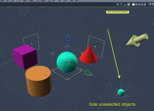

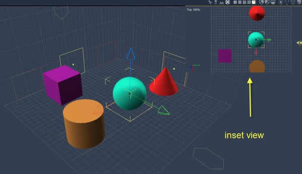

    Something that can help a bit with reducing sluggishness in the Assembly room is to enable the Hide Object in 3D View checkbox (not to be confused with the Visibility checkbox). The object will be invisible in the Assembly room, but will still be rendered. I usually use this for replicators after I have them set up the way I wish, and am moving on to another scene element. It really helps if there is a large number of replications.
