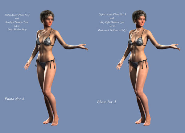

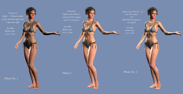

    1452 x 1040 - 306K
    1993 x 1032 - 480K
  • Scott LivingstonScott Livingston Posts: 4,352
    edited September 2014
    All your distant lights (including specular lights, if I recall correctly) need to be set to Raytraced (shadow type) in order to get rid of the glow. That's what I'd recommend, however if you'd rather not do it that way, Victoria 6 also has a preset to turn off SSS on the inner mouth.
    For UE2, you can experiment with different settings (most of the time I use Occlusion with Soft Shadows or Occlusion with Directional Shadows). I don't think any of the UE2 settings would contribute to the glow you are seeing. There is a very detailed, in-depth thread on UberEnvironment2 which is worth checking out if you want to learn more about the various modes: http://www.daz3d.com/forums/discussion/5320/

    Hi, Scott-Livingston,
    Thanks for the Tip about the SSS
    - Made new scene with Victoria 6 only and with Previously mentioned light set-up.
    - even after changing the setting the SSS shader for Inner Mouth,Gums,Teeth and Tongue (Diffuse to 0%, Sub surface Off-Of to '0' and Sub surface strength to 0%) still I could see the little Glow effect on face and finally HIDING these in scene pane, I could able to remove the glow effect. But still the Face skin texture differs with Body skin textures.

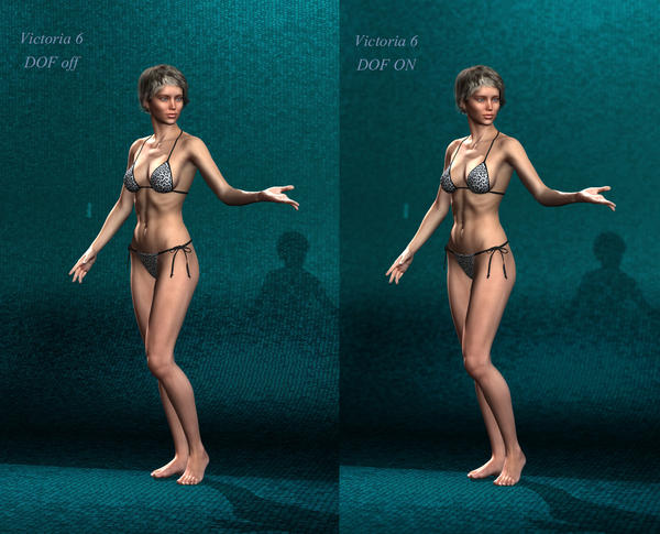

    - changed few setting and Light color for Key-light and UE2 and did quite number of test renders.
    - In my previous renders the images were Out-of focus, the Camera setting were as per Gia tutorials, found these are not proper for my scene changed and accordingly and did final rendering with high quality settings in Advance Render pane.
    and the my final renders are below.
    1607 x 1298 - 2M
