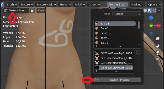

HI.
I started a converstation in the DAZ Studio Discussion about how to paint directly on to a G8 figure (I was hoping to a free alternative to the likes of Substance Painter). I was informed that Blender could do this so I fired up Blender 2.91 and gave it a try. I followed a couple of YouTube tutorials although none show how to do it on an imported model but I got there - mostly. The problem is that Blender seems to select the wrong UV map for the surface I'm trying to paint and I can't figure out how to change that. I have a full screen capture below which illustrates the proble, Blender's UV image editor is stuck on the face even though I have the Torso selected on the figure.
Any advice welcome.

    I see that the mods have removed my Blender screen capture - I can't imagine why because there was no nudity - it was just a white figure like a marble statue.
    Maybe it was too big - I've reduced the size now.

  • PadonePadone Posts: 4,326
    January 2021 edited January 2021
    Just tested it and I don't get any issue. You just have to paint over the selected texture and save of course if you want to keep it. Please note that the saved textures will overwrite the original ones, unless you change the name. So an easy way for custom textures is to pack then unpack so to make a local copy.
    file > external data > pack / unpack
    687 x 374 - 73K

  • marblemarble Posts: 7,500
    Clearly your Blender viewport doesn't look like mine. I tried to follow YouTube tutorials and used the Texture Paint tab which opens two viewport panels side-by-side (see attached image). The left hand panel is an Image Editor showing the UV maps. As you can see from the above discussion, those UV maps were what caused me all the confusion. I saw that what I was painting on the torso was appearing on the face UV. I thought that was a problem (turns out I could ignore it though).
    As for saving - I just saved the image to desktop, I don't know what pack/unpack does or how to use it. My save was a flattened UV style map with whatever name I gave it.
    @marble It's the same, mine is the right one. I don't care about udims since I paint over the geometry rather than the texture itself. So the texture tiling makes it work, even if it's not converted to udims.
