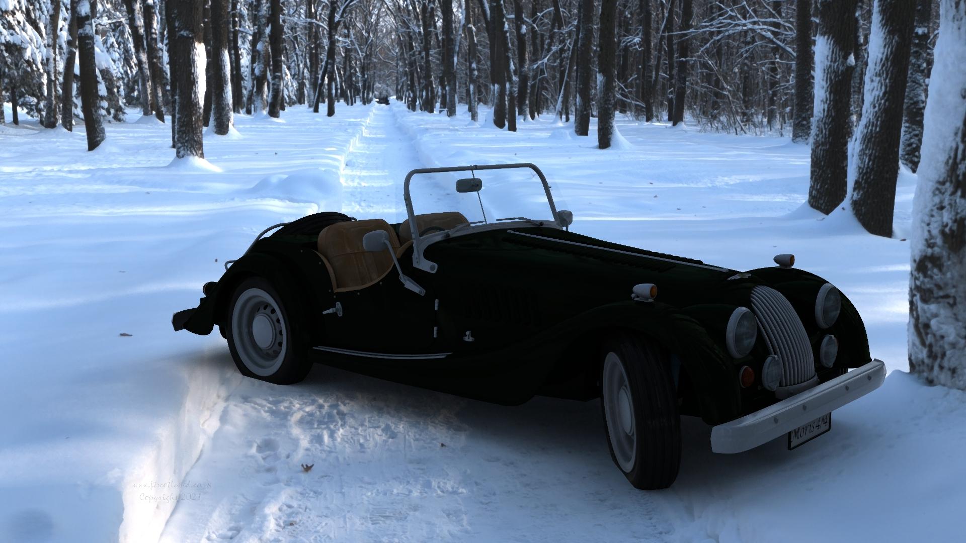

    I used one of the HDR Snowy Forrest Path and a car.
    2021-01-23 17:20:40.687 Total Rendering Time: 45.34 seconds
    Click on image for full size.
    That's excellent. But what happens when you move the camera to shoot another vantage point, say from the driver's side? Then you have to start from square one, right?
  • FishtalesFishtales Posts: 6,231
    Thank you. Unfortunately you are stuck with the orientation of the hdri and it is difficult, to near impossible, to get the view you want based on it.

    @RenderPretender This is as best as it gets.
    2021-01-23 20:16:42.139 Total Rendering Time: 45.20 seconds
    1920 x 1080 - 1M
