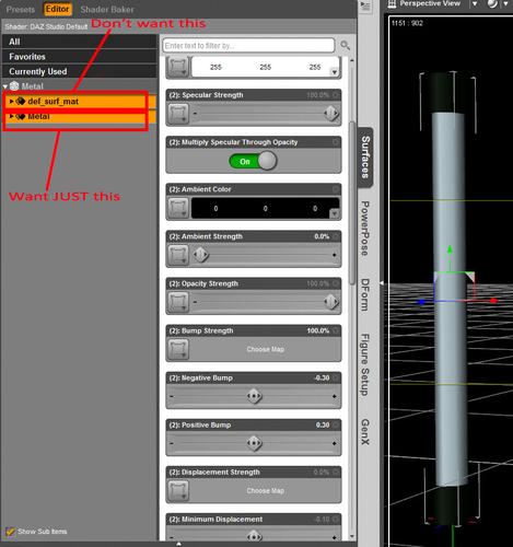

Hi all,
I have modeled and UV mapped a couple simple objects in Hexagon and am sending them to DAZ Studio to use. When I go to add and adjust textures in studio, in addition to the material I added there is another material called "def_surf_mat." There are no polygons included in this texture so it's not actually affecting anything, but it offends my sense of neatness.
Is there any way to remove this so it doesn't show up? Is there something I have to do in Hexagon before sending it over so only my material shows up, or somewhere in studio I can edit this?
Thank you!
Mark
827 x 882 - 115K

    In DAZ Studio, select your object and switch to Geometry Editor (Tools - Geometry Editor). Than in Tool Settings tab (Window - Panels (Tabs) - Tool Settings) select the Surface you wish to remove and click with right mouse button on it to get the menu and use Remove Selected Group(s). Save your object as figure/prop (file - save as - support assets - figure/prop assets).
    ben98120000 - Thank you! That worked perfectly.
