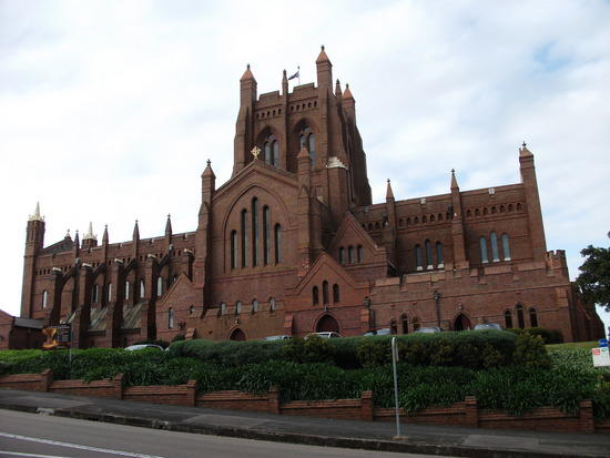

Gooday, I have been commissioned to make 24 images for an advent calendar. They need to feature local landmarks.
I want to model this Cathedral in Architools but I don't have a stack of time as the job needs to be done by end of next month.
So my question, those of you who are familiar with Architools, is this building doable in a few hours (say two) bearing in mind I have had the briefest play with the program.?
The brief play I had I couldnt get the uv'ees to sit right but I think it was because i didnt have the shader mode right ?? Anyone have trouble with the uvees?
I am just modelling from a corner view most probably.
There will be crenellations with the roof sticking above them. (see old pic for example of what I mean)
And there's those flying buttresses - I guess they will have to be vertex modelled?
thanks in advance - sorry I haven't been round for the challenge :(
a better view of one side is here https://www.flickr.com/photos/67307569@N00/14616184160/sizes/l/
Edit : I'm also looking for more tuts on architools - I see Eric (?) has three PDFs and three Vids on his site - but there must be more

    Wow, you have taken on one heck of a task!
    Sorry, can't help with Architools - have it, but hardly touched.

    Taking that job would make even an Atheist pray!
    Good luck! I wish I could help, but I don't have any experience with Architools. I do see some repeating architectural elements that could help save time, by duplicating them, but that's about all I can tell you as I'm still a VM retard.

    It's going to come down to how well do you understand what you're modeling and then how well you can use your tools. Most good architecture works best with floor plans and elevations. Do you have those or are you just winging it by eye?

    While it's been awhile since I've played with Architools, I really do like modeling buildings with it. That looks like a very fun project, some very nice complex architecture going on there.
    Maybe someone who is absolutely expert in Architools could model that in 2 hours, but I sincerely doubt it. I'm figuring it would be more like 6 - 8 hours, for someone who is already very well versed with Architools. I do think Architools would make be much faster then modeling from absolute scratch, say in the Vertex modeling room, but I really think doing such a complex structure in 2 hours is very ambitious!
    That would be to do the exterior only, if you have to do interiors too, then I'm guessing at least a couple of days to put that all together.

    Yes, thanks Jon, I could model it in the VM - the simple bits at least - their is ribbing over one portico that would be a PITA maybe. There's only one round window that would appear in the image I think - but starting with a cylinder and extruding the edges to make the rest of the that wall looks better than a boolean as far as Uvees?
    The finished products will be in a high profile place in town and revealed one by one, and also projected onto the side of the building.
    I showed the clients some images with the protagonists (Santa etc) using shadow catcher placed on photographs - they were happy with the result but I wasn't so sure about it myself ...
    The other thing I could do for the complicated walls would be just to use alpha maps on flat vertex meshes - not sure how good the quality would be...
    thanks for your advice on the time too, I've done a lot of modelling in the past in anim8or but not so much in carrara
    EDIT: just exterior thank fully!

    The floor plans will help and you ought to be able to get a rough shape of the building with ArchiTools, but you are going to have to do a large amount of modeling to the basic building shape you get with ArchiTools in the Vertex modeler and model other things the windows, doors, and several other structures.
    What is is going to come down to is how quick and good of a modeler you are i the end.
    From what I can tell it may be faster to just model it all in the VM.
    Out of curiosity I went and goggled the cathedral and found some other views of it and it looks like it is going take a good amount of time just to get the stained glass windows on it modeled.
    The cathedral's website does have some close up images of various parts of the building and they have a PDF paper that shows repairs done to it that has some good architectural images that will help in modeling. If you can get a larger better copy of those images you'll have an easier time modeling it as a few were perspective drawings of the cathedral.
    I also saw some photos of construction on the site which make it look to me that some parts of the basic building structure will be best modeled in the vertex modeler and not done at all in ArchiTools at all even though you may want to initially do them in ArchiTools to get a rough shape. The right side of the building looks like it might be easier to just model completely in the VM after looking at construction image of the cathedral.
    Good luck.

    I agree with Jay, it would be easier to model in VM. I have architools, but not sure it can do all the arches, pillars, cornices and etc.
    I fooled around a bit in VM using some non-Boolean techniques to see if I can model in VM a gothic arch.
    It's straight forward and uses mostly techniques that Hexagon has. Using the bridge tool to connect the arches keeps the quads going and the levels straight.
    Of course, this was just a testing of modeling so it's not something I would put out there for final view. In my opinion, more fluting of the columns, different styles and even using the spline modeler to extrude out some of the fancier stuff like fluted columns or the start of a flying buttress that has "design" to it.
    Just a contribution to the thread, could be done easier and in a billion different ways and this is just one type of gothic arch.

    From the looks of it, I'd use Hexagon, maybe Blender (or another decent modeler...Carrara's VM isn't very well-rounded). You will need one or two profile curves for the detail stuff (like the 'molding/edge' detail around the edges of some of the windows), and one or two "cutter" shapes for the arched windows and such.
    First, I'd block out the whole thing with just cubes. Use multiples...not one cube that you then add edges, push/pull faces, etc. and shape. If you do it that way, you will likely end up with some bad artifacts once you try using boolean's on it. Modular is good. :)
    After you have it blocked out in rough form, go in and add the details. As I'm looking at the pictures, it seems there are really only maybe 4 or so "shapes" for the entire building; the edge molding, arch-windows, angled buttresses, and the roofing. Other than that, it's just flat walls. The more detail you add, and the closer you get to the end result, you can start to refine the weird little shapes and inconsistencies that will crop up.
    All totaled up...I'd guesstimate about 8 hours to do (assuming no inside, of course).
