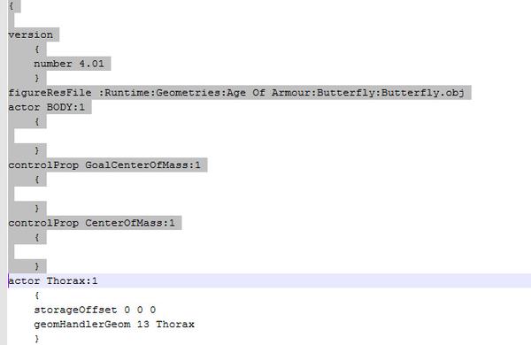

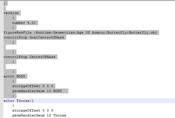

    First thing is to open your CR2 in a text editor that has line numbers (notepad++ etc), now the highlighted area in picture one is what you have in the CR2, picture two is how it should look.
    After you fix that you then have a few small changes to make to the rest of the file
    Line 482 you will find actor BODY, stick a :1 after BODY so the line reads actor BODY:1
    Line 703 do the same thing and add a :1 after BODY so it reads parent BODY:1
    Line 3754 we have another BODY to add a :1 to, and another BODY on line 3760 to add the :1 to.
    save it and you should be good to go.
