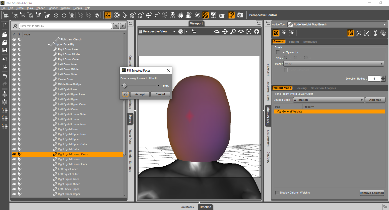

    Okay so I gave this a try too. Works well for most of the bones but for a few there is a remnant left over. Is there something I should be doing next for these then, or just skip them?

  • I'm not sure what you are showing there.
     The area in red will not go away. Using the weight removal popup shown made "all" of the colours on most of the other bones go away.
  • With my colour vision I'm not seeing the red, and I'm not sure why it wold persist.

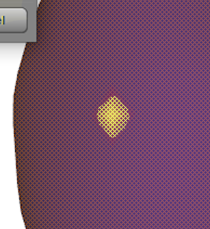

    edited January 2021
    My apologies I did not realize that. Most of the activated area clears but not small red areas on some of the bones. From the above image, I enlarged and cropped and changed the color for the approximate area that was red into yellow. {my image editor wanted to change it all the net to yellow too lol ...}.
    Okay, we don't know why it persists then, hopefully just skipping it, maybe it won't matter then. I did find that some of the bones, in particular the brow bones and lower jaw bones will still affect the helmet BUT as best I can tell, those would also be the bones required to change the shape of the helmet if one were changing the figure's shape. However many of the expressions no longer affect the helmet ... so that's good. We'll work with what works, thanks.

  • There may well be morphs associated with soem of the expression bones, and those would project into the helmet if it was not rigidity mapped.
    That's quite possible. Thank you.
