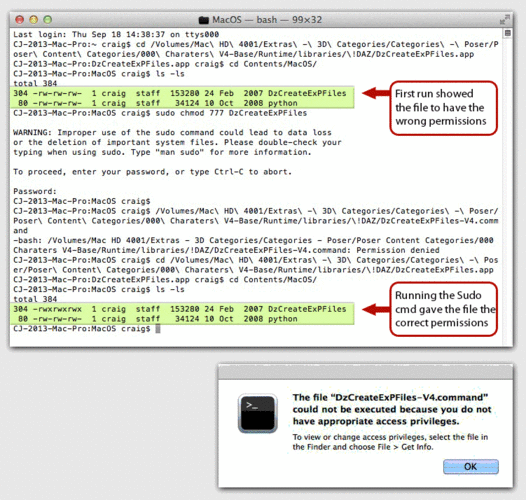

    in Runtime/libraries/!DAZ there is a file, app-file, named DzCreateExPFiles.app.
    That one is executed by the cmdline script installed, called DzCreateExPFiles-V4.command in the same directory.
    Try to run DzCreateExPFiles.app by double-clicking DzCreateExPFiles-V4.command. If it doesn't run (which I suspect) or give permission errors start the terminal, type cd (then drop the DzCreateExPFiles.app onto your terminal window), hit return.
    now type cd Contents/MacOS/
    type ls -ls, should look something like this if it has the correct execution bits set.
    304 -rwxrwxrwx  1 totte  staff  153280 24 Feb  2007 DzCreateExPFiles
     80 -rw-rw-rw-  1 totte  staff   34124 10 Okt  2008 python
    if it doesn't have -rwxrwxrwx , type
    sudo chmod 777 DzCreateExPFiles
    Will require an authentication.
    Now try to doubleclick DzCreateExPFiles-V4.command and it should run
    Hope this helps.

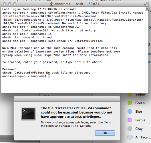

    Responding to Totte: I tried what you suggested, but I am not very familiar with using Terminal. I probably screwed it up, because I still couldn't use "DzCreate........V4.command".

    ok, yes, it's difficult when you're not used to it, but as you saw, the problem was there, either the script or the scriptexecutpr.
    Will try to explain better...
  • TotteTotte Posts: 15,110
    (a) You should drop the DzCreateExPFiles.app, not the DzCreateExPFiles-V4.command file onto the terminal.

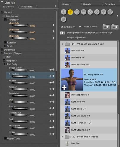

    edited September 2014
    Your runtime seems to be correct.
    I went in to Runtime / Libraries / Characters / Daz People and brought V4 into the scene.
    I then went to Runtime / Libraries / Pose / Morph injections and injected the V4 base morphs and then the V4 Morphs++ using the Icons which (on my PC) appear below all sub the folders in that folder. I am not certain if this is standard, as my runtimes are very customised, and as you can see I am using my old P6 runtime here, as that is the version i had V4 installed in to before I upgraded both PC and Poser.

    Try to run DzCreateExPFiles.app by double-clicking DzCreateExPFiles-V4.command. If it doesn’t run (which I suspect) or give permission errors start the terminal, type cd (then drop the DzCreateExPFiles.app onto your terminal window), hit return.
    now type cd Contents/MacOS/ etc
    I get the permissions listed and they're incorrect so I go through the sudo chmod 777 DzCreateExPFiles and type my password. Now when I go through the steps to see if the permissions have changed, they have and it all looks as I think it should (following the steps).
    But when I then double click on the DzCreateExPFiles-V4.command, I STILL get the error. :(

    Try change permissions on the V4.command file too then. ls -ls to check its permissions.
  • JoelLovellJoelLovell Posts: 117
    Ok, thanks to your original step by step instruction, I was able to change the file's permissions. (I had originally tried to 'cd DzCreateExPFiles-V4.command' but I figured out I'd need to perform the action to the surrounding folder instead).
    Anyway, I was able to run the DzCreateExPFiles-V4.command file and it opened in the Terminal and it gave me a large list of what it's doing and then it says [Process Competed]
