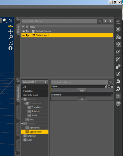

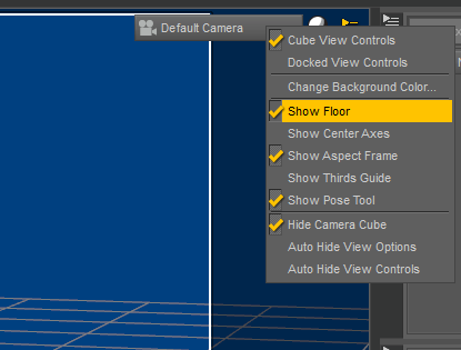

While I am making adjustments ... Is there a way to hide the 'floor' grid and the light 'arrows' without turning out the lights? Sometimes they make detail adjustments hard to see. I wouldn't want the grid gone all of the time, but those arrows are annoying, lol.

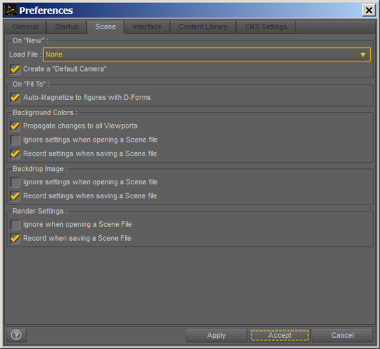

Looking better so far. Now I need to turn it back to white and figure out why the default camera doesn't load on start. How do I save it as the default way to open once I have it back the way I want it? Or is that in the above tutorials?
Under the Display -> Scene View options for the light, you should be able to switch the "Visible" to off, without affecting the rendering. You can also achieve the same effect with the little "eye" icon on the scene tab.
Simplest way (that I know of) is under Edit -> Preferences (or F2 if you prefer), the "Startup" tab. Make a "base" empty scene file with appropriate lights / camera / render settings etc etc... save it out as a DUF somewhere, then set the "On "Launch" Load File" option to that file (remembering to tick the box, of course ;-) ). The example below I had a "startup-test.duf" file where I was testing things awhile ago...
When I use the eye, the light goes out in the workspace, though :(
Oh, right, it's being "helpful"... that may actually be a "feature" we can't control (if the light is not Visible, then your scene will go black).
If you're using distant lights, note that you don't HAVE to have the light (and therefore the arrows) actually at the origin of the scene - you can move it off "to one side", just pointing at the right angle, and it will illuminate things the way it should. Alternatively, I _think_ you can Scale them down a bit to make them less conspicuous, without affecting the illumination properties...
Also, I think I've (just) discovered why you may be missing the "default camera" that everybody talks about - did you check your Edit -> Preferences -> Scene tab, the "Create a "Default Camera"" option? ;-) (needless to say, if you want a different scene setup when you do a File -> New, you might wish to set that "Load file" option below to your saved "blank" scene file as well).
Thanks :D I even found a couple handy tools new to me with this re-setting :D The thirds guide and the center axes. :D
