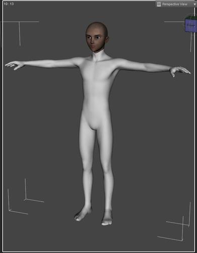

Something I've been having issues with for a while now is Slosh's Generation 4 Legacy Shapes in use with products such as the Supersuit Basic Suit. I had recently seen an update for his Gen 5 Legacy Shapes for G2F in the DIM and so I was hoping to revisit the matter, thinking the issue was finally fixed. However, things still seem to be a bit erroneous when one uses shapes such as S4, H4, and even both F4 and F5.
I'm wondering if other people here have experienced anything similar with other articles. I remember Slosh saying something about the poke through when I originally contacted him direct on the issue, but my exact memory of it is a bit fuzzy.

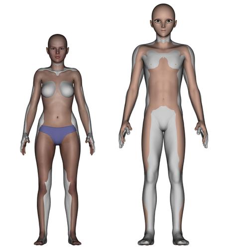

    Ha! I knew there was something I was forgetting when I did that update a week ago. That update, by the way, was for Stephanie5... her left eye would close a little when you dialed in her body.
    Anyway, as I told you before, this is not a problem with the Legacy Shapes. It doesn't happen on other clothing, so it must be a problem with the SuperSuit. Since you are only just now addressing it in the forum like I suggested, I took the time to find out what the problem is.
    The SuperSuit (and the Basic Suit) already have full body morphs created for various characters, including the Gen4 figures like Hiro 4. So, it gets confused. By deleting the FBMHiro4.dsf file from the SuperSuit's data folder, I was able to get the suit to fit properly. I didn't try the other characters you mentioned, but I do see them listed in SuperSuit's data folder, so I am pretty confident the fix will apply to them as well.
    The .dsf must be deleted... simply dialing it out of the supersuit will not work. See the attached picture for results...

  • RCDescheneRCDeschene Posts: 2,817
    Ahh, I see. That actually makes sense! Finally! Thank you so much, Slosh! :D
