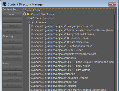

    When I say content mapping, I mean: From the Content Library pane, click the menu icon, then select "Content Directory Manager" from the menu. Expand all the '+''s to see a complete list of every mapped content folder that DS should look in to find your content. (Screenshot shows a part of mine, yours will look different.) If you put everything into one runtime, maybe you only have one of each, poser and native DAZ Studio, in which case you don't really have to back it up, you can just write it down and re-enter it (when needed, although I didn't think you should have to do that for the upgrade, just on a fresh OS install or new PC.)
