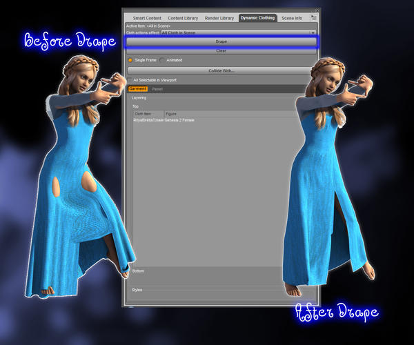

Dynamic clothing works a little differently to conforming clothing, which makes up the majority of outfits you'll find in the store. To fit it properly use the Dynamic Clothing tab and run a drape. Here's an example below.
As HoF says. This is an image I did using the Poser version of this cloak and running a full drape each time. (my own texture added)

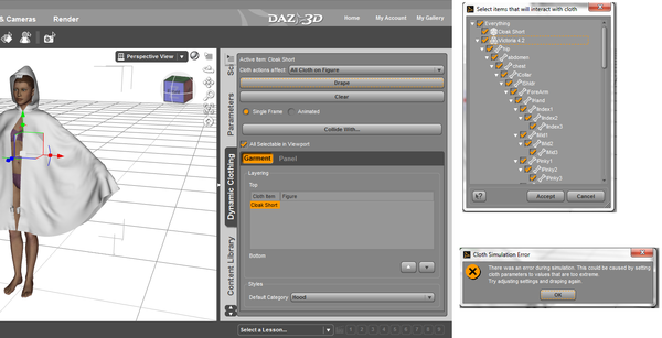

This is what I'm working with. Even just selecting it and hitting drape gives me the error.

There is no need to post images of V4, just post an image of the DCC, and the Scene pane, and the error box too if possible.

This is what I'm fully dealing with. Don't know if it matters, but in the scene tab, a basic camera is added and the cloak is sometimes deselected. I have to click the x next to it to get the check mark back.
I found when dealing with the dynamic sheet that you only want to select the parts in the scene that they cloth will actually come in contact with. For example, if you have clothes on a person and a dynamic cloth over that, then select the clothes and only the bare parts of the skin that the cloth will touch. Leave the others unselected for collision.
Also, it's normal that dynamic cloth is un-selectable by default (Or so I'm gathering as I get the same thing on the sheets)
Also, I've gotten that error a couple times while first playing around with the sheets, just keep trying. Dynamic clothing are finicky creatures.
Looks like there's already a pre-existing drape. Hit the 'clear' button to remove it first before re-applying the drape. That error is usually caused by previous drapes, as it sometimes pushes cloth vertices into locations that are difficult to work with.
