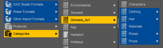

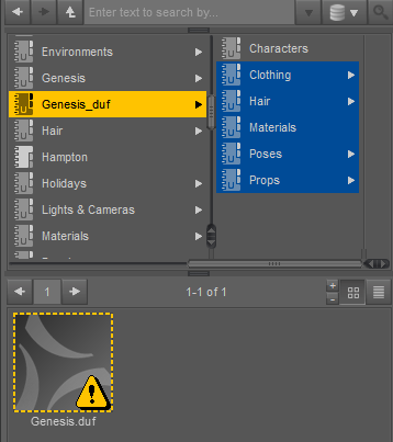

  • atticanneatticanne Posts: 3,009
    edited August 2012
    All of my new content files, such as genesis.duf, show up in Categories with a yellow triangle containing an exclamation mark on the thumbs.
    Also, almost every old file (DAZ and other) throws a Duplicate ID error. Is this possibly due to the capitalization?

  • Richard HaseltineRichard Haseltine Posts: 111,380
    Duplicate IDs are a flaw in old content showing up in DS4.5 - I have a script to fix DSF files (see list of free scripts in sig), and most store content that suffers the issue has been updated. It has nothing to do with the directory structure.
    The yellow warning triangle usually means file not found - do the items show their thumbnails, or just a generic DAZ icon?
    edited August 2012
    Richard, I understand that I have to update my purchases or use the scripts. But for the content that came with RC3?
    Did you install the content to a different location this time? The database may still point to the old location, from which the files were uninstalled when installing the new version (though I thought the system had been fixed to use relative paths now).
    I've only installed 4.5 RC 3 once. I uninstalled 4.0X before installing 4.5. It installed under Studio and I moved it under My Library.
    That's your problem then - moving content (outside of DS) breaks the smart content. If you reinstall DS, making sure you select teh right location for the content, that should fix it. You could also try reimporting metadata from Content Library option menu>Content DB Maintenance.
    I seldom use Smart Content. I love my categories more. Surprise, surprise! I ran "scan known directories" from the Content Library tab and all the 4.5 thumbnails are fine now and it's all working. I'll try your suggestion for the Smart Content though.
