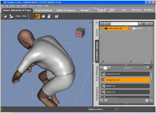

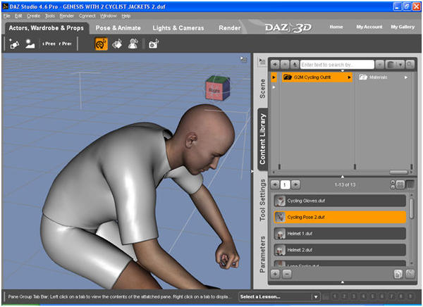

Not sure I have followed the correct procedures when I have used both of the cyclist's outfits on top of each other. It looks not bad, except the top jacket sleeves are too loosely fitted.
I can't remember if I have chosen shirt loosely or shirt tight when I have used transfer utility tool to get it to fit. The under vest was bodysuit tight.
Which is the correct method when fitting 2 pieces of clothing as in this case on top of each other? As you will see on attached images it seems ok, only sleeves too wide for cyclist jersey.
Also wants to add here that I have used scaling on top jersey first to get it to fit better over under vest before I have exported it as .obj.
Laura
628 x 456 - 63K
628 x 456 - 64K
628 x 456 - 67K
628 x 456 - 62K

    Getting the items to fit in the zeroed state is a matter of modelling, getting them to stay fitted as you pose is probably going to require adjusting the weight maps manually - and may require morphs. You can add a Smoothing Modifier to the top layer and set it to collide with the lower layer, though that isn't ideal.
    Thank you for your advice. I am just start learning clothing so every bit of info helps!
