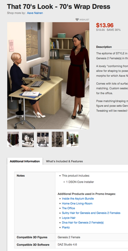

FauvistFauvist Posts: 2,291
I'm often interested in clothing, but which specifies that it is compatible with Daz Studio (but not Poser). What is it about the clothing that doesn't work in Poser? Is it the file format? The shaders? (I'm not talking about dynamic clothes). Is it possible to buy it, open it in DAZ Studio, then export it to work in Poser? Here's an example of the type of clothes I'm interested in: http://www.daz3d.com/aave-nainen/that-70-s-look-70-s-wrap-dress
Thanks!

  • SixDsSixDs Posts: 2,384
    In the example you used, I'd say the answers are both yes. The dress and poses are in .duf format so are not natively supported in Poser. The shaders would probably require at least some manual tweaking in poser to obtain the desired results as well. Others more familiar with this item or others like it may offer more specific details and advice.
