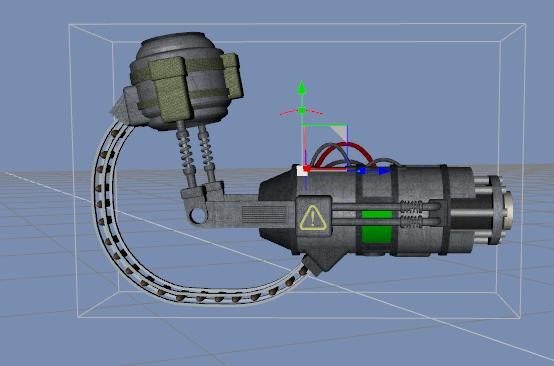

How would I go about making it able to bend and twist at the joint?
I've tried reading through a tutorial on a wiki page, but it's all greek to me and they keep linking back to previous tutorials for refrence on other things.
554 x 366 - 88K

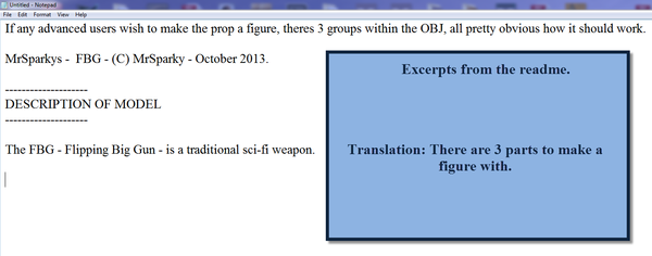

    If any advanced users wish to make the prop a figure, theres 3 groups within the OBJ, all pretty obvious how it should work.

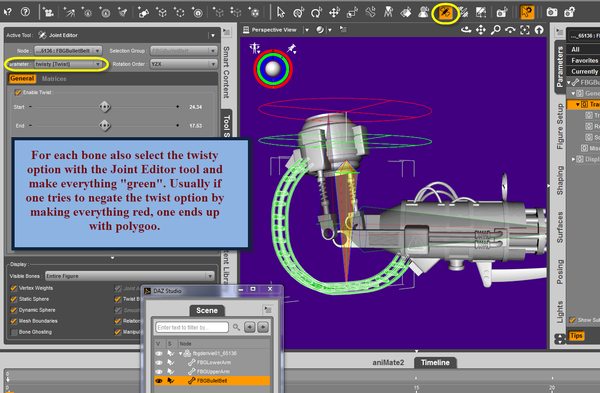

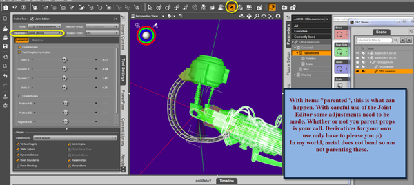

    ;-) yeah ... all kinds of stuff over there. I'll also fav other people's tutorials 'cause there are many people who know lots of stuff :-)

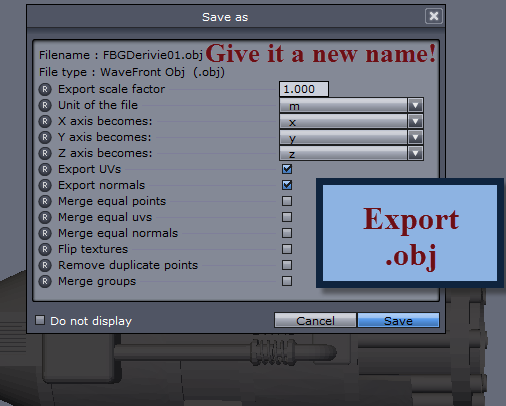

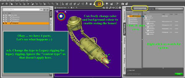

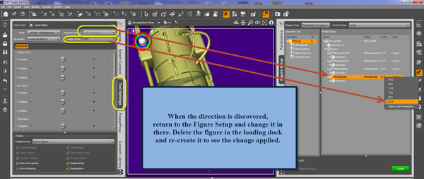

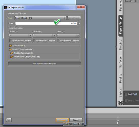

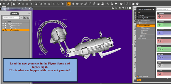

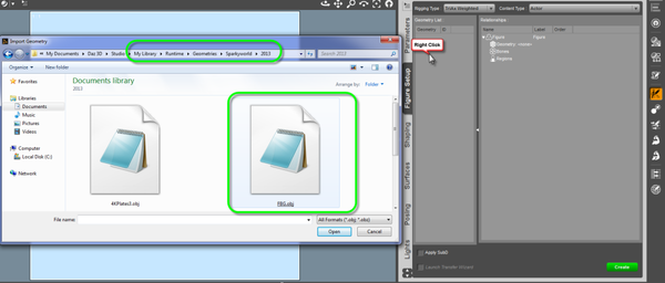

    Here's a basic what I did today ...
    1000 x 423 - 174K
    1000 x 424 - 162K
    838 x 763 - 53K
    1000 x 426 - 99K
    1419 x 558 - 51K
    edited September 2014

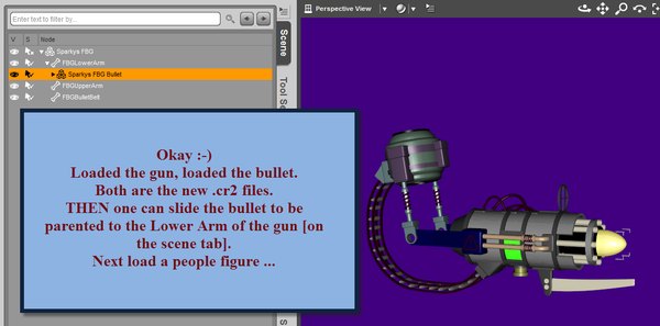

    And we discovered that the bullet must be a separately created prop or figure. I chose a figure .cr2 so we can pose that along with the gun.
    506 x 406 - 28K
    825 x 528 - 55K
    1000 x 537 - 144K
    1000 x 549 - 206K
    1000 x 422 - 174K

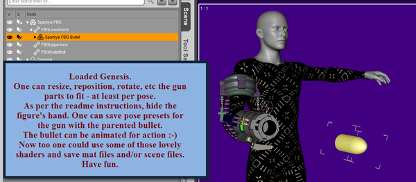

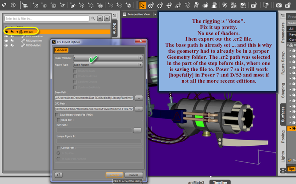

    some more pics ...
    Remember, "PowerPose" is your friend when rigging. All one really needs to do with it is "reset pose" :-)
    1000 x 494 - 145K
    1000 x 621 - 232K
    1314 x 860 - 254K
    1000 x 447 - 210K
    1000 x 494 - 161K
    Post edited by patience55 on
    And the last two images ...
    Thank you Sparky, this is a neat great big gun alright :-)
    1111 x 486 - 141K
    1152 x 571 - 105K
