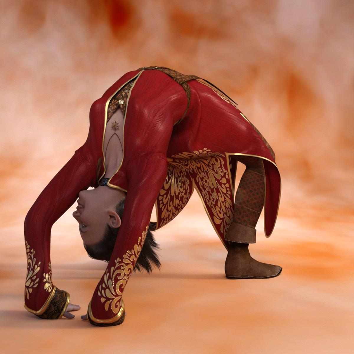

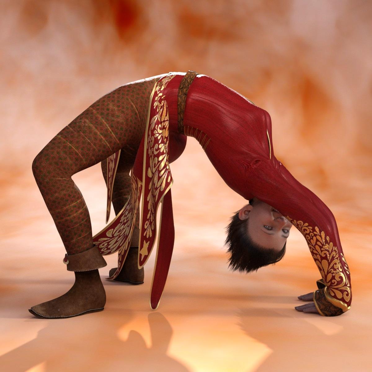

    Below is Ensley again from 2 different angles.
    1200 x 1200 - 334K
    1200 x 1200 - 307K
    Post edited by Artini on

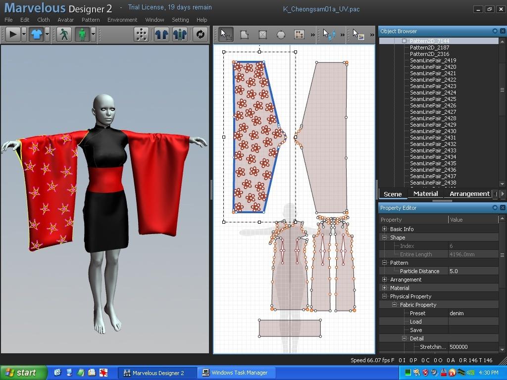

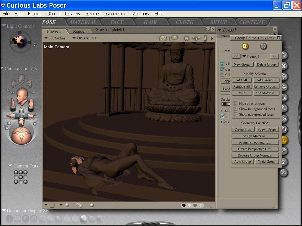

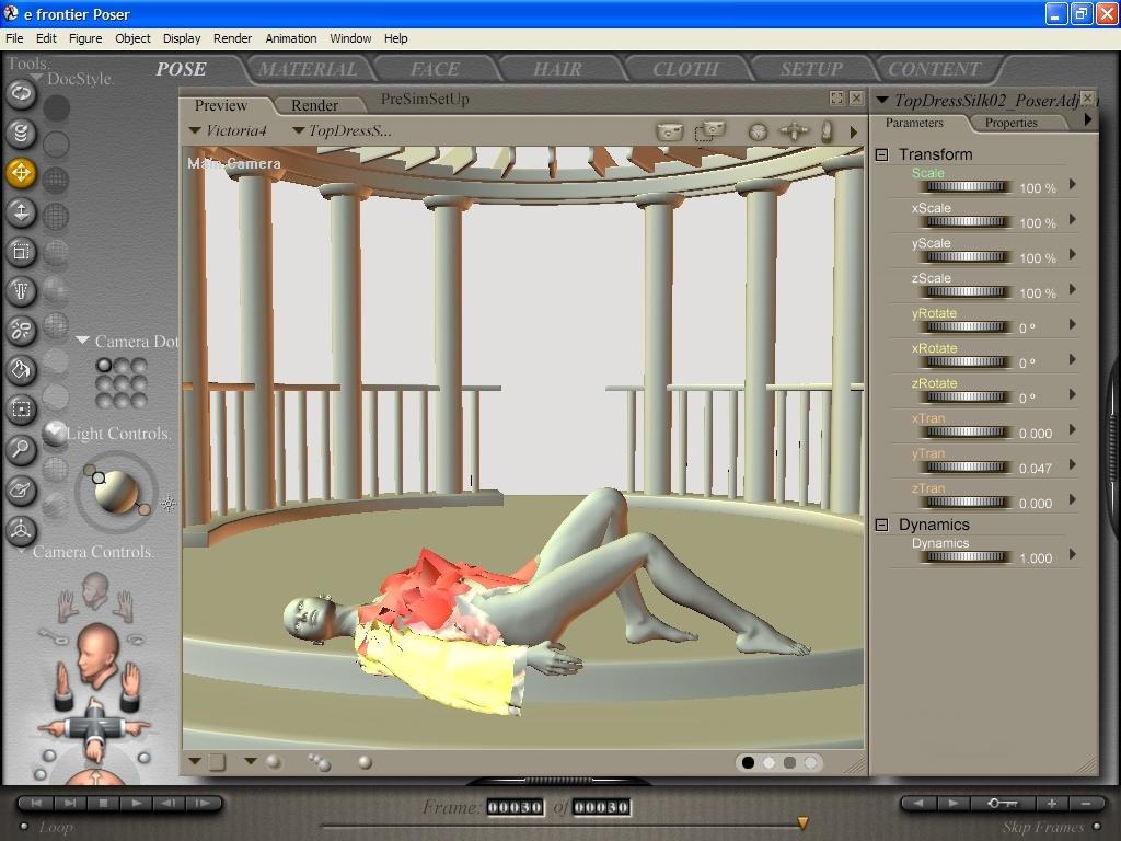

    First, I don't use dForce  --  I have better solutions at my disposal, so I have never bothered to even try it.  If they would have started out with user interaction as I have available elsewhere, I might have given it a go.  If they add it in the future, I might try it, but for now, I don't have the time to waste on another limited cloth sim.
    @ Victor_B :
    Just like any discipline, you have to learn 'how' to drive your machine.  I'm sure anyone outside of PHP coding wouldn't have the faintest idea of any code postings from you, or you describing the work with nomenclature.
    I don't even use dForce, and yet I know exactly what every one of the posted nomenclature in your posts are for, and what the should do.  I learned to drive the machine years ago, and learned all the stick-shift controls, because as of yet, no one has created an auto-matic...
    But, why I really logged in to respond to this thread, because I have been studying and using cloth sims for well over a decade :
    Poser Explosion :
    Poser Non-Explosion  --  The completed drape (sans previous explosion)  --  The hand coming down to rest on the cloth was the culprit in this situation.  Apologies for the dark screen  --  Pre-render that is at sunset :
    Marvelous Designer Explosion :
    Marvelous Designer Non-Explosion  --  Single arm cloth drape before I added the second set of cloth flowers  --  Initial re-sim with both sleeves, and KA-BOOOOMMM  that you see above  :
    * Even with experiencing explosions in MD2 during my beta testing (pre-MD2 going live for Trials, and then purchasing) and Trial, I still purchased it, because it is a great program  --  Even my decade old first generation MD2.
    Maybe now, with the later versions, most might not encounter explosions on a regular basis  --  I don't know, I only own the first version, but I can still explode it now and again, and definitely can still explode Poser's cloth sim, even up to PoserPro11.
    Don't know about Poser12  --  Haven't tried it, nor ever plan to.  They lost me when they locked PP11 to online schema (now, I just use my PP2014 instead), just like MD2 did, which is why I never purchased or will ever purchase again.  I am already building my own solution...

    I was just qualifying with my first sentence that even though I use cloth simulation, that I did not use dForce, so I would be of no help here.
    I agree with you, and I was not suggesting using anything else  --  That's why I did not go on to list all the sims I use.
    My post was in response to Victor_B ( and why I added the @ Victor_B ), and his statement :  "Did you ever seen explosions in Marvelous Designer or Poser? Analyze this. ;)"
    Hence, why I showed the explosions in both of those software.
    My point was, and I am in agreeance with you that the product you paid for should work as advertised for you (regardless if it works for someone else who just says it works for me, so the product works), that all simulation software can have issues, not just dForce.
