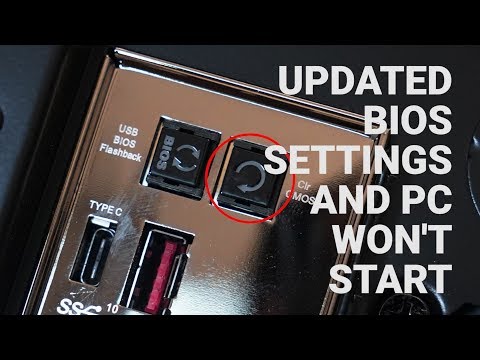

    Sometimes, resetting the BIOS might also do the trick. How to do that varies though which each motherboard.... ( I was lucky enough that the MB on my system had a clear CMOS button on ther back when I had this happening to my system, though that was not related to any update.....).
    This video might help a bit...
