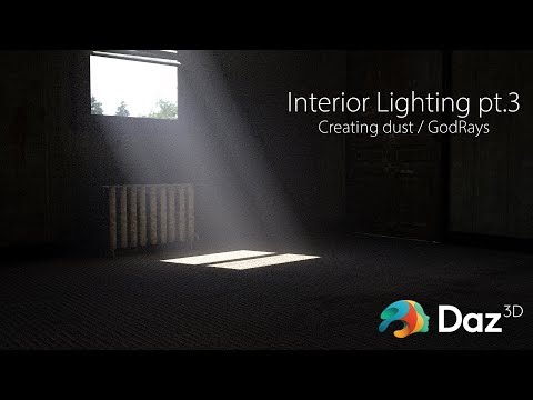

    https://www.youtube.com/watch?v=taK2QYkha_o
    Particles and god ray with a box and refraction. Works really well.
