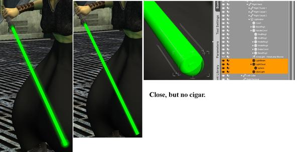

    using the uber tube light, and the 'glow' shader mixer applied to the surface of a second primitive over that, or was it under that. I ended up doing both.

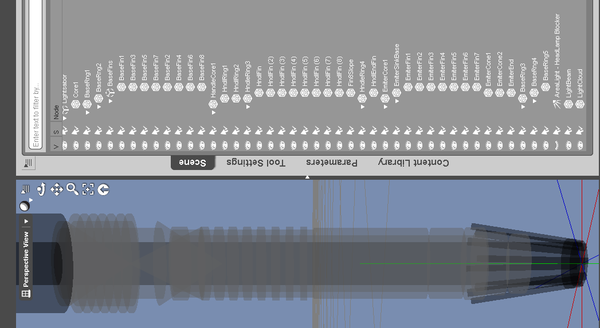

    Thing is, a simple cylinder primitive dose not have a rounded end like the real deal has, so the effect only looks good from a few angles. Just look at the examples in my gallery "MiscCoolStuff" in my sig. I tried adding a sphere to that. Yes that lightsaber was made entirely from primitives in Daz Studio.
    1600 x 811 - 528K
    1047 x 573 - 30K

    Sorry about the leftover text in that one pic, I just fixed it, that was for the Amazing skins thread not this one. This is quite an appropriate thread to discuss Lightsabers.
