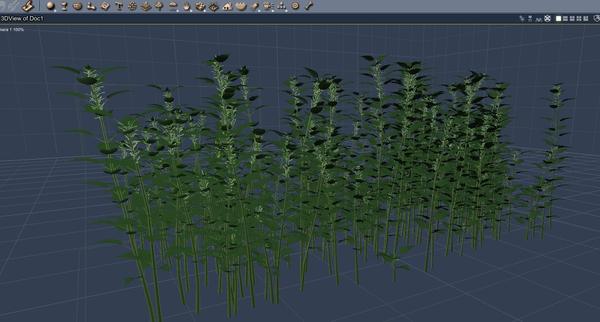

    2000 x 2000 - 7M

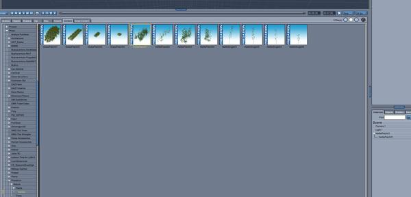

    Because I could successfully load the props from one location but not another, I think it might be useful to make sure you are loading from the correct location.
    - what did work for me? - load from "My Daz3D Library" in the props/predatron/nature/plants/nettles folder in the content browser
    - what did not work for me? - attempt to load from "My Daz3D Library Runtime" in the props/p3da_nature/plants/nettles folder
    The first is the location from which Carrara loads files in the duf format, which this prop set is in. The second is the location from which Carrara loads files in the old Poser format, which didn't work even though the Predatron prop did have PoserCF companion files available. This is the first prop that I know of which I could not load the Poser style when one was available.
