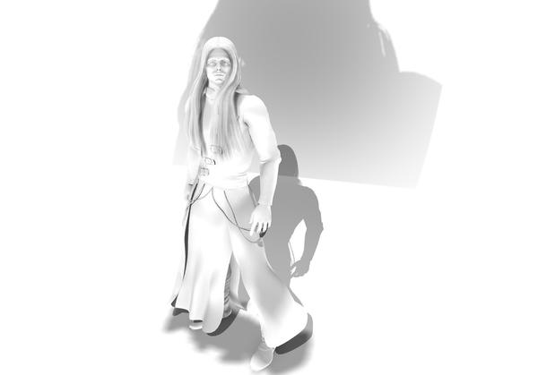

is there any way to render "shadows only" on DS4 Pro as you can do in poser pro? I'm a noob when it comes to DS4, and still haven't been able to figure it out.
(attached pic shows what I'm trying to accomplish in daz Studio)

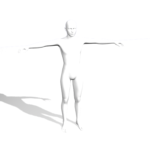

    You just need to remove all textures and put a white diffuse color
    Then add two lights (I tried with distant lights) . One casting shadow and the other without shadows. Intensity > 100%
    Finally you can adjust the shadow contrast by playing with the Gamma Value in the render settings (Gamma > 2 seems good)

    You just click on the "shadow only" option in poser, and render, then you get the result I showed in my first pic.. it's really that simple over there. I don't want the character to be invisible, but i want all shadows rendered on his face and features, just like in that pic.
    I don't mean to start a DS4 Vs. Poser thread, just inquiring how can I accomplish the same in DS4... but the ubersurface lights option seems to be the winner as of now, will definitely look into it.. thanks for the replies!
