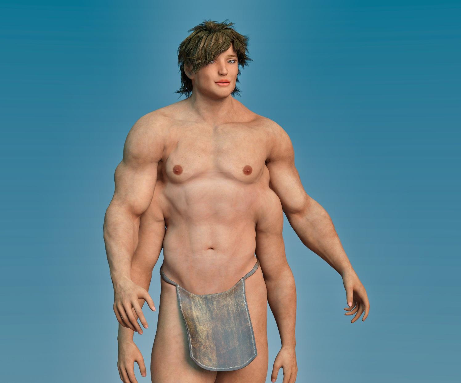

    Ok, using Genesis Four Arms with Forest king, to demonstrate issues.
    First, obviously, texture seams unless you make a skin exactly for using the geograft. That's no surprise.
    But second, the four arms shape doesn't match the regular arms at ALL. The product will adjust to standard/core shapes (like weight and fitness), but anything new? There's... just no way.
    This also means the arm movement is all messed up. It's not incredibly bad here, but I also tried it with Ribbits and got skin folding on itself and all sorts of nonsense.
