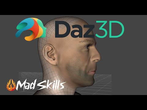

  • charlescharles Posts: 866
    edited January 2021
    Here is a YouTube video I talked about using shrinkwrap in blender and turning into a G8 morph.
