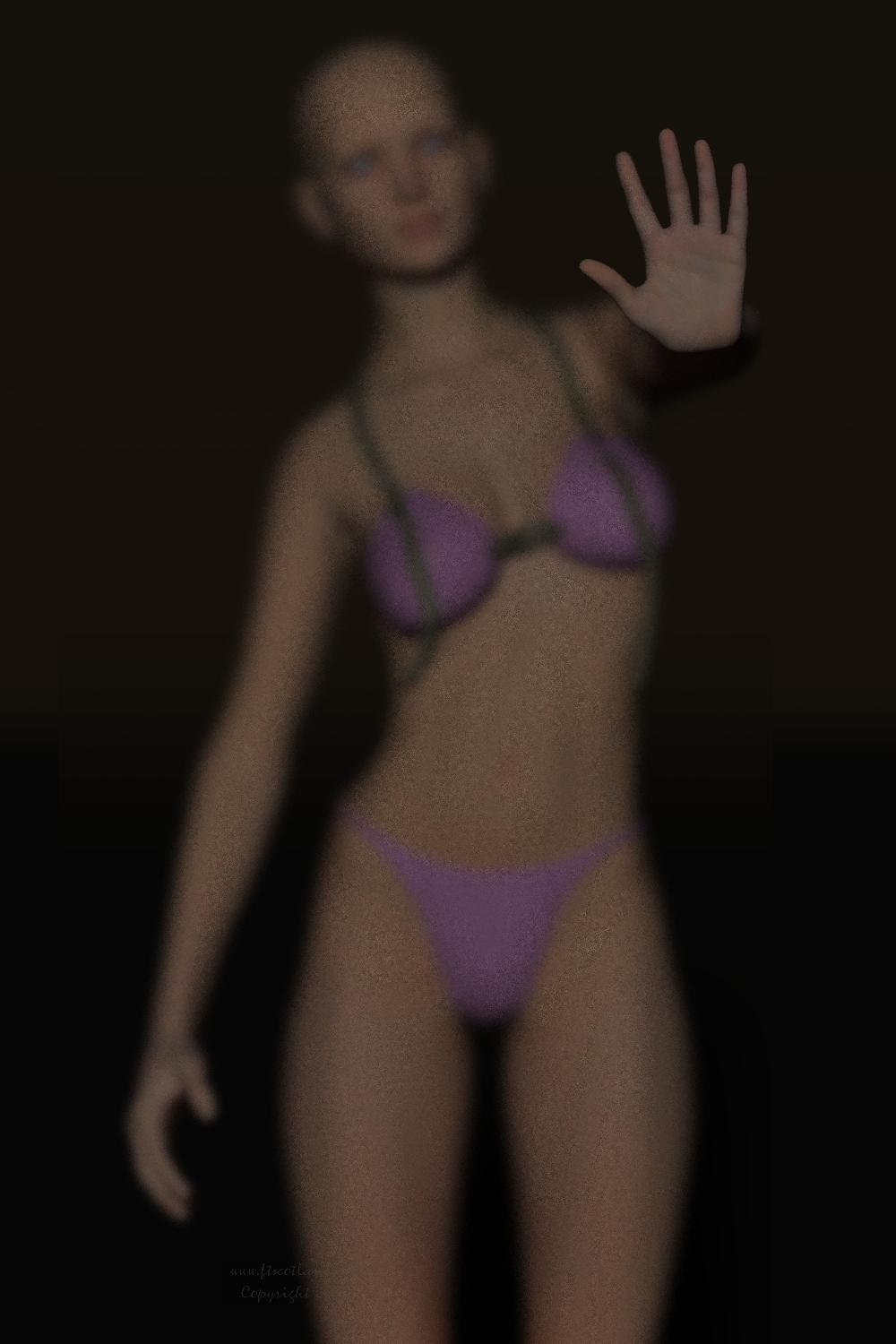

OK so I have created a scene where my charcter is putting her hand out in front of herself in a "stop!" kind of pose her hand is meant to be touching a frosted window and my camera is on the other side, the "window" is a plane with the slightly frosted glass Iray shader applied. The effect i am going for is hand is sharpish and face will be blurred.
Now i want to use a spotlight or emiisive surface to pass light though the window and light her up.
BUT the light will not pass though the glass at all no matter how big I make the old lumens but if the light source is on the other side of the glass she is lit up and I can see her though my window
So what am i doing wrong?

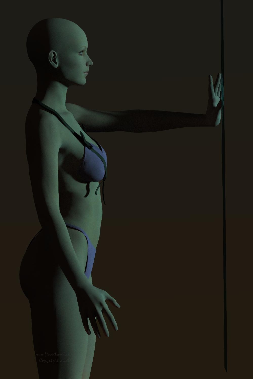

    OK so the shader being used is "glass solid lightly frosted" which is one of the DAZ studio shaders nothing exotic :)
    I do not want dirt or scratches etc i would like it clean so i can do that in post if needs be etc
    In the sceenshots you should be able to see the scene its just a figure behind glass from the point of view of the camera and a spotlight to light the scene i tried an emissive plane and it was worse than the spotlight. Anyway in the realworld a frosted window would not drop the light level so much I can do this using multiple lights where one or two would do normaly but then this is not the real world I suppose smiley
    TYhin walled does not seem to m ake any difference?
    In the screenshot the light is getting over the top of the plane and lighting the face which is lighter than the hand which is nearer the light but behind the glass if that makes sense

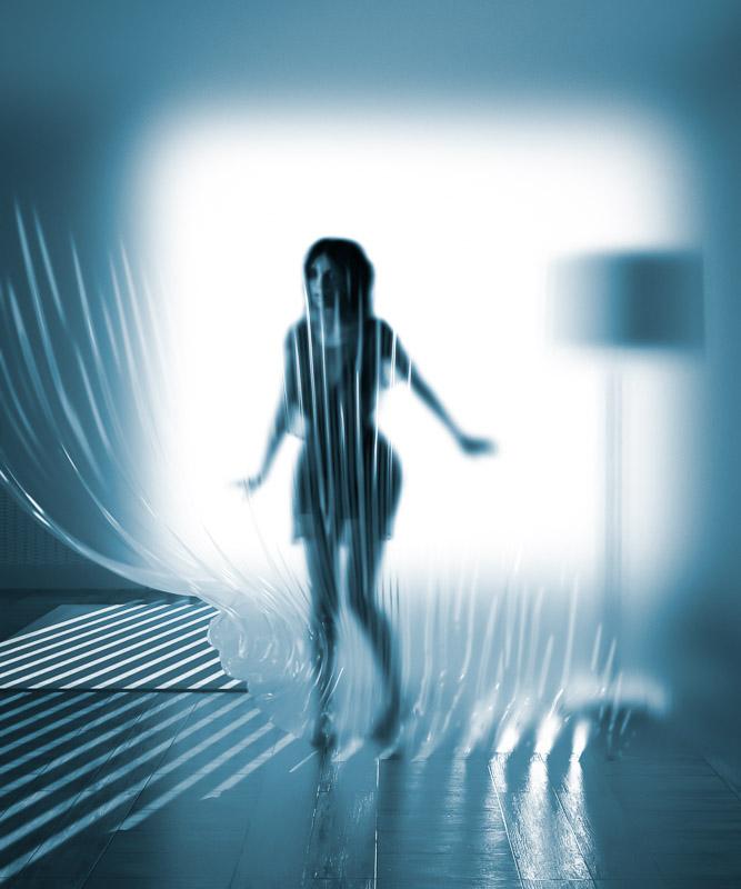

    OK I have been down a load of very deep rabbit holes since starting on this idea and I never really got the front lit affect to work for me as i wanted so i went a bit sideways and converted my "glass" to dforce and blew it around a bit
    And this is what I got which i will live with smiley
