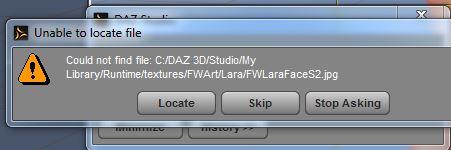

Downloaded and installed FWF Britany with DIM. When I try to apply the Mats B. (Strong Lights) -> !BaseMat I get a "Could not find file error for Runtime/textures/FWArt/Lara/FWLaraFaceS2.jpg.
This appears to be a texture for the unreleased FW Lara HD product that somehow got used in this preset. I tried all the makeup options and they work fine, including the MakeupRem. So far it is only the !BaseMat that is feeling lonely without her friend Lara.
Did a bit more digging around. The S2 mask appears to be the Specular mask used for the Lips. Using the strong lights mats, all the other skin regions use the specular mask in both the specular and specular 2 color. The Lip zone is only using the S2 mask in the specular 2 color and has no mask in the specular color. I suspect Lara accidentally loaned her friend Britany a lip specular mask.

  • FistyFisty Posts: 3,416
    Oh that's annoying.. there is a lip spec mask in the texture folder you can tell it to use. But just a tip, the dimmer light mats are set up for regular lights, the bright is set up for the super bright sets that seem to be used all the time now but I really really dislike. Try the dimmer base mat and light set that comes with it, it's much better.
    Anyway.. I'll let Fred know so he can send an update in, I'm out of town on an annoying laptop at the moment.

    Thanks Fisty. I checked all the lip mat options. They all appear to work fine, and they all set the FWBritanyFaceS2 mask in both the specular and specular 2 colors.
    You can fix this problem yourself by just setting the mask on the specular color in the lip zone. If that sounds too complicated for you, then it looks like the Lips00B preset in Lip folder under MATs B. (Strong Lights), will fix the missing texture for you too. In fact any of the Lip mats in that folder will fix it, but the Lips00B seems to use the same specular settings and diffusion texture as the !BaseMat.

    Here we go:
    What happens is I load V6. Zero her out, then apply the second Brit mat from product view. It generated the error below
    451 x 150 - 21K
  • Serene NightSerene Night Posts: 17,704
    IT appears to be the 'strong light' base mat that is the culprit.
  • Fred Winkler ArtFred Winkler Art Posts: 795
    oh I see, yeah it's the same issue then. getting the files to be updated. Still don't know what happened since I know my tester changed it during testing. So who knows. like I said in the meantime just use the "!!!INFO" one instead of the "!!BaseMat" and you wont get that issue.

    It never occurred to me that the !!INFO preset would do something. It does indeed apply the mats without any errors. Thanks.
    yeah with DUF files you cant have empty ones for some reason, so I always copy the base mat across, which is why it is even weirder that it does that right when it doesn't the other one. :)
