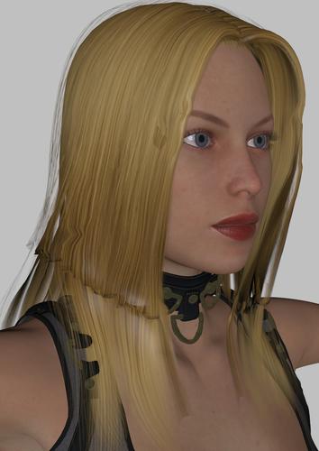

I did a quick search on the forum and couldn't find anything about it, but I'm wondering if anyone has come up with a fix for the Genesis 2 issue with hair from previous generations. I've included a shot where I've found it most problematic (Valen's Hair). Now I'm sure most people just parent it to the head when it comes to this kind of issue, but I've had a difficlut time getting it to lay on the figure' chest correctly. Since this is an autofit problem, I'm sure there isn't a solution, but I thought I would ask anyway.

  • fixmypcmikefixmypcmike Posts: 19,741
    Select the hair and make sure "Show Hidden Parameters" is enabled on the Parameter tab options menu (rectangle with horizontal lines in the upper corner). Click on "Currently Used" and you should see the autogenerated morphs. If you aren't sure which one is causing the problem, try zeroing them one by one until you find the culprit.

    Yeah it was a morph. Unfortunately it's one that's pivitol to the character, my conversion of one of AMR's Genesis Proportion morphs. I lack Gen X so I had to do it the old fashion way. Without it, the hair hangs in mid air. I might have to set up Genesis for the size I want and go through each node documenting the scale to properly get her to scale, without causing weird effects with the hair.
