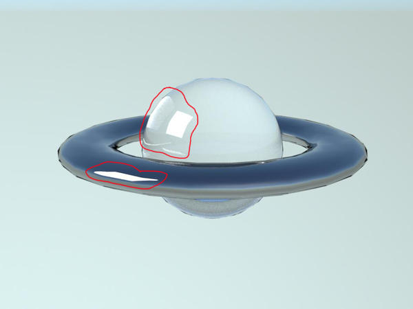

    the reflection is the light pane or other geometry you are using reflecting against a glossy surface
    you can move the lights, adjust the size of the pane (which will alter the physics of the light) or make the surface less glossy or matte.
    the reason this is happening is it would happen in real life, a square emitting light would reflect as a square over a reflective surface in it's path.

    I made a sphere with a high gloss shader (car paint) and a torus with glass. in the upper left hand corner is a primitive pane that is converted to a light emitter. Both surfaces (the sphere and the torus) are reflecting that object.
    another possibility is an IBL HDR image is being used a as light and the image contains a bright surface in which case I don't think there is a way to remove the reflections.
