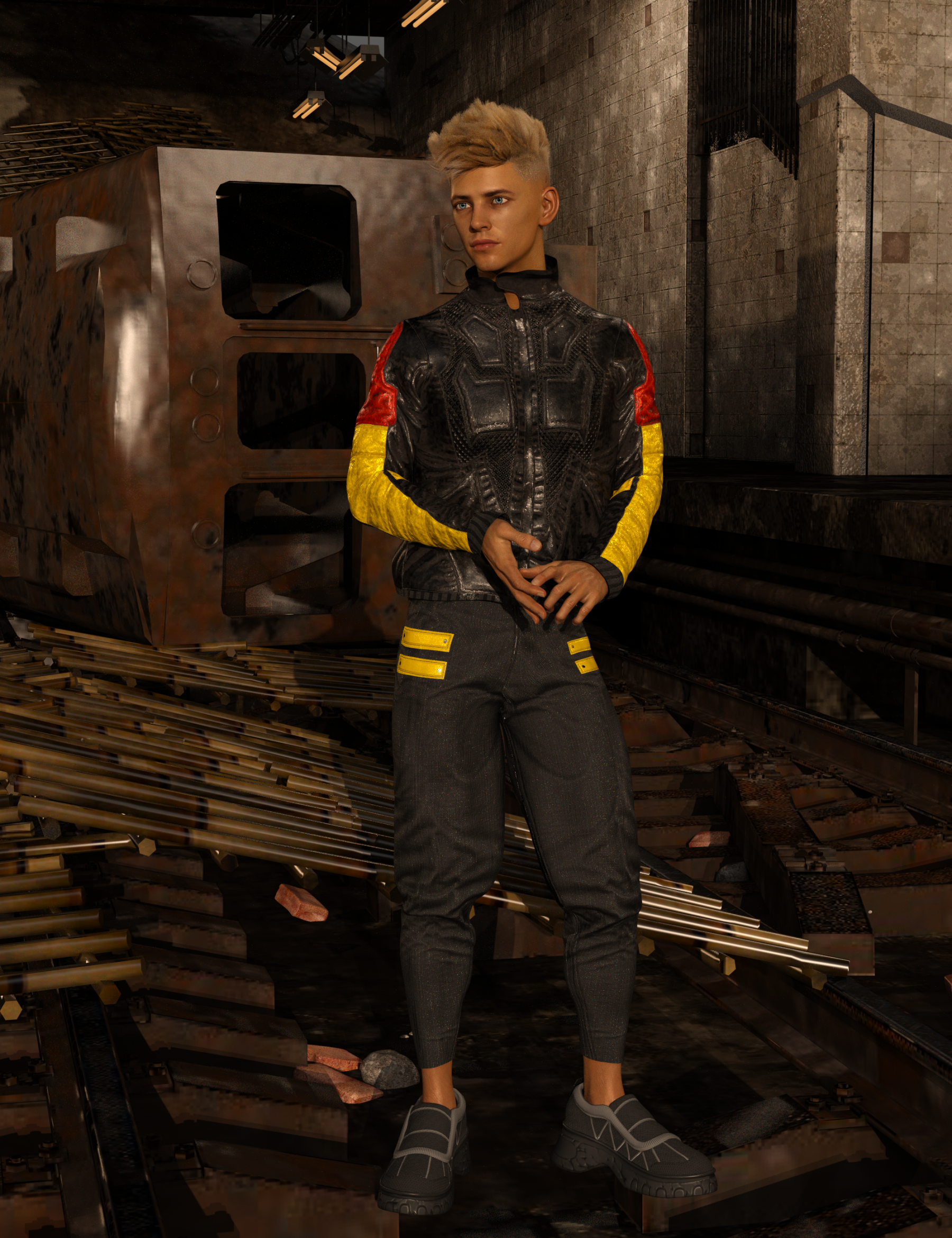

  • BandoriFanBandoriFan Posts: 364
    edited December 2020
    Walls block so much light. I just got Interior Light Pro and it's actually pretty good so far
    https://www.daz3d.com/interior-light-pro-for-filament-and-iray
    I did a couple of comparison renders one using it and the other default
    1800 x 2340 - 6M
    2000 x 2600 - 7M
