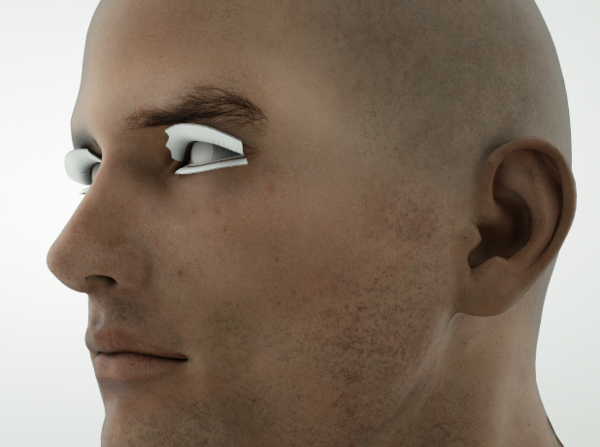

If anyone can help me, I would be very appreciative. I am having an issue in Octane after exporting a model in Daz.
I seem to be having an issue with eyes, hair, and eyelashes. When I import the object I get "billboards" for where the hair goes instead of the texture with the alpha channel. The eyes do about the same thing. I attached a photo to help illustrate the issues I am having.
Does anyone have an idea? I have looked around and can't seem to find any help. I also have tried to solve the issue myself by tinkering with settings, but I am still at a loss.
The picture I attached has a model without hair, but that's because if the issue with the eye lashes can be solved, it will be the same solution for the hair I am assuming.
Thanks for any help that can be given.

    If that is a G2M figure be aware that there is a cornea and an eye reflection surface. One or the other can be turned to matte (or removed in Octane) or both can be converted into a specular material. For the eyelashes I am guessing the opacity map did not come across. You could try the reload DS materials button (not sure what it is called and cannot check at the moment) or go to the NGE and manually load the map from there.

    For the lashes (and hair) just assign an Octane diffuse material and add the transmap from the character to the opacity channel in Octane. You can set the colour with the diffuse colour or with a texturemap. For the eyes, assign the Octane "Clear Cornea" material to the cornea and eyereflection zones.

  • artech7artech7 Posts: 0
    I tried a few things recommended.
    I attached the results.
    With the lashes, I have 2 maps that was exported. One with a white back ground and one with a black background.
    Attached an image of what I mean. I assume the file named "Lashes O" is the opacity file hence the black background. But as you can see in the face render, it gives a black shadow around the eyes and a slight white tint to the lashes.
    As for the eyes, I managed to get 1 eye right, but the other one is off. I played with the scale a bit, but I just can't get both to line up.
    I attached a file of both eye maps I got from the export. Again, assuming the file named "eyes O" is for opacity. When I use that, the model looks like he just took a dose of LSD and has huge pupils but no Cornea.
    I think the lashes will be an easier fix at this point. But if you guys need more info from me I will be happy to oblige since you are taking your time to help me.

    @ eyelashes
    For some reason when you save the .obj the Opacity map is also used as Diffuse map.
    This is unexpected because in the DS Surfaces tab there is a color used for diffuse and NOT a map.
    Maybe the node setup for the M5 character is a bit different...
    To fix this:
    Exchange the Diffuse map for 6_eyelash with a "RGB color" node and select a tone that matches the hair of the character.
    Compare attached screenshot.
