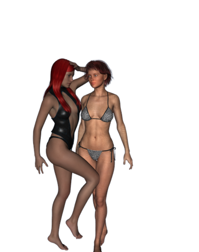

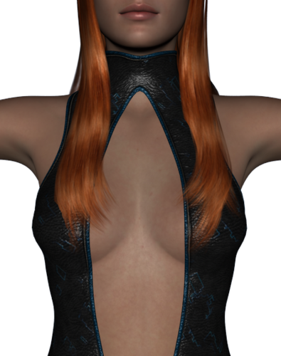

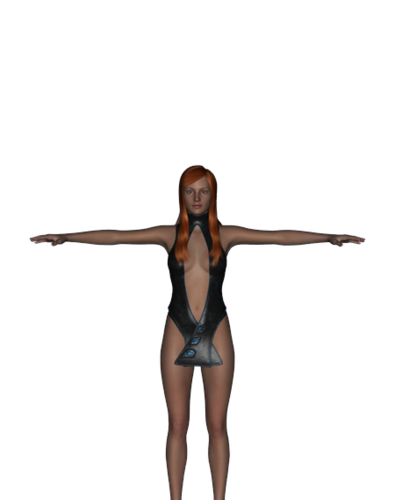

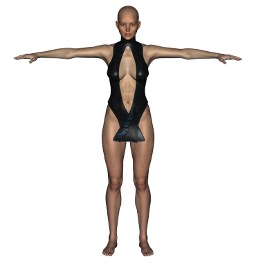

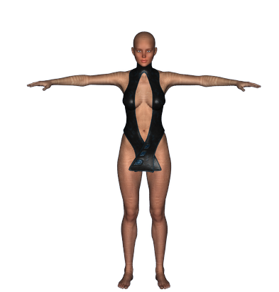

I am confused because I keep getting this weird affect in my renders only on victoria 6.(strange lines.) Another weird thing close up the effect disappears. On genesis 2 female does not get this affect same can be said for anything else I have. The only one that gets this affect is victoria. Some example photos below. First set is of victoria. The second set is genesis 2 female.

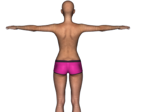

    I still get the same affect as before. Just at your number I get splotchy spots around the shoulder. I tried making it higher I tried making it lower always the same affect on Victoria. making it a higher number makes it worse. lowering it keeps it the same. I even tried 0.010.
    I always get the lined affect unless I do a close up shot.
    I edited to add another photo of the lines.

    I wanted to post one more image of genesis 2 female and victoria in the same scene. I think it helps to show a better difference. Also note it was not always like this that I am aware of anyway. Just something I found when I am not close enough. I get these lines in rendering. If I change the rendering to a lower rate I have no problems.
    I am asking for help because I am wondering if a file is missing or maybe it is a bug I am stuck with? It could also be a texture problem with victoria. I am not sure how that would make sense since I can get up close and the lines go away. I want to know if there is anything I can do to fix this. Also want to know if I should be worried about it if I plan to get other skin or shapes?

    Anyway some better photos below closer up shots of the lines. The other photos I didn't do much editing for them sorry about that. I just wanted to show a unedited version of the lines.(For me they were big. This would have to do with the screen I use.)

    It is a result of AoA's SSS shader that is applied to the skin, the default Shading Rate of 16 is to high. A setting of 4 will work for most normal size figure viewed from typical distances.
    There is no error. As Jestmart has pointed out its related to a feature in the Ageofarmour Subsurface shader.
    Setting the shading rate for those surfaces to a value or 4 or lower will take care of the banding but dont do it until you are ready for the final render as it does increase render times a bit.

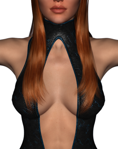

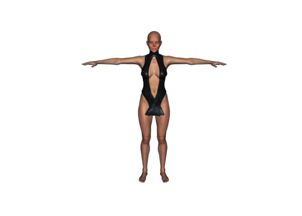

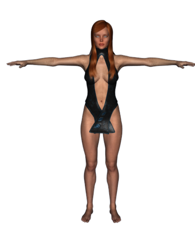

    I just want to say that amazing skins that I picked up fixed the problem. Sorry I did not update this sooner I wanted to be truly sure the problem was fixed. I can take fairly far away shots with no problems with amazing skins. The reason why I wanted to take faraway shots is because I have been thinking of making a large scene. I'm setting some photo examples of before and after below. In both photos it was taken at the same spot. The same lighting and everything. The first photo is what happens normally second photo is with amazing skins. I Just used the presets to get this result.
