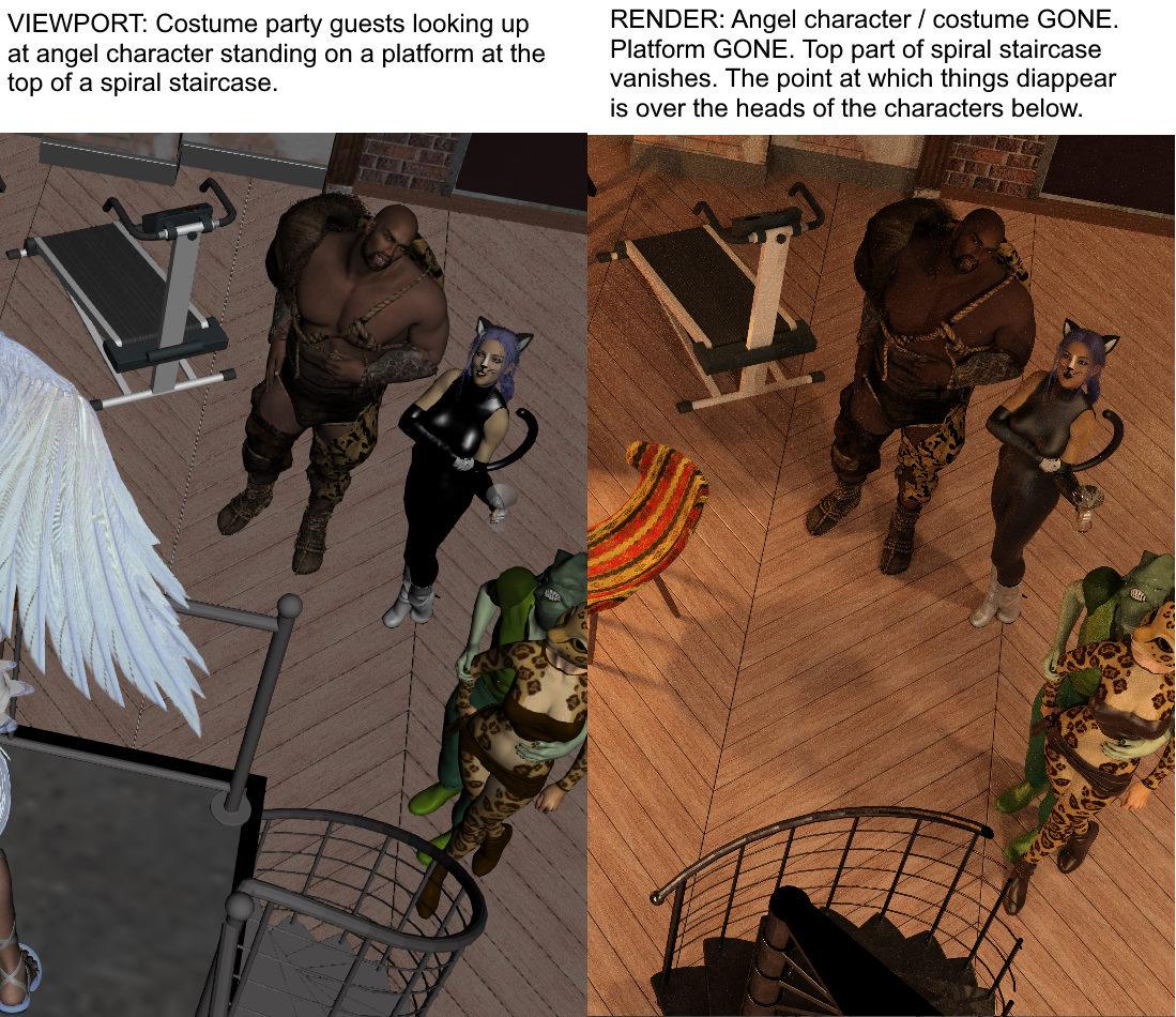

Haven't come across this before, and not sure where to even start troubleshooting it. Set is the Old Manhattan Apartment. In the scene, the camera is looking down at a chracter standing on a platform that has a spiral staircase up to it. Characters down on the floor are looking up at the first character. I've attached an image
It looks fine in the viewport, but when rendered, the top part of the scene is gone. The platform the character + costume disappear. The spiral staircase ceases to exist partway to the top,
I don't have any Iray clipping planes in the scene, at least not that I can find. The platform is too far from the camera to be inside the normal "too close" clipping boundary.
Looks fine in the viewport, but both preview and final renders shear off the top part of the scene.
Any ideas?

    The attachment to my original post which was an image showing the problem seems to have disappeared, at least in my browser...
    It's here: https://www.daz3d.com/forums/uploads/FileUpload/22/a35720936a515048be09eadf1bd38c.jpg

    jim_doria said:
     I might have played with the Iray Interior Camera I found on Deviant Art. Is there a way I could tell?
    When I saw the image i thought right away of these HDRI plane cameras like that one.  But you wrote you checked planes?
    To check, in scene click arrow next to Iray Interior Camera and expand.  Even if the camera is OFF, the planes in the hierarchy underneath are still on.  And they totally do what you are seeing.

    OK, I moved the camera so no part of it was touching the ceiling. I looked through EVERY SINGLE ITEM in my scene tree to try and find clipping planes but there are none. Then I created a brand new camera with the default settings and pointed it at the problem. Things got even weirder. See attached.
    The top part of the attached image shows the camera at Y=255. The scene renders normally. The bottom part shows the camera at Y=260. Suddently all the geometry above a certain point just disappears and all you see is the HDRI background.
    It sure LOOKS like a clipping plane. Either that or the ground plane somehow in the wrong spot, but I checked the render settings, even turned ground plane off. And anyway, the problem seems to exist well above ground, somwhere between Y255 and Y260
    Anybody seen anything like this before?
    Yes. Everytime I forget to toggle of my planes included with the special HDRI camera, and am using another camera.  That's what it looks like. Or some version of crazy clipping like that.
    Otherwise, never.  So far.   (If it's something else and new, would love to know what it is.)
