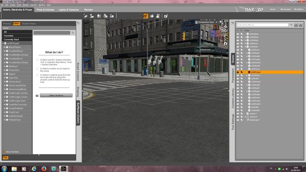

    Here is a screen print of the item I'm talking about ( and there is several items like this one, it's not the only one ) :
    Big City
    Stonemason could combine all these items into one single item/folder/file, so there is a way to do that ( now, maybe not using DS... ), and if there is a way to do it, there also is a way to undo it.
    And the gang tags are simply items ( artfully ) pined against walls, they're not part of them.

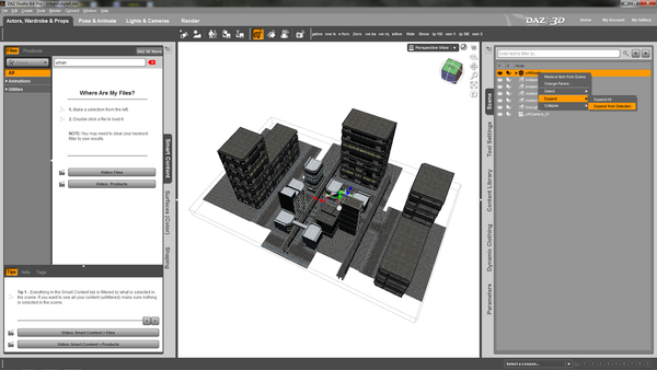

    wow, that's tiny and can't see it. Anyways I have all of Sronemason's Urban Future sets and if this one follows suit then each building, road, etc are separate pieces all parented.
    So what you want to do is select the top item, right click and expand from selection to get the full list of objects.
    Then you can either hide or unparent and delete what you don't want.

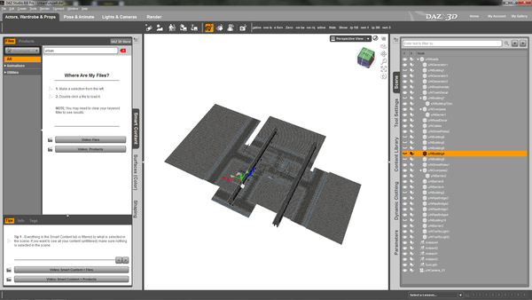

    I don't have that set unfortunately, but you should expand all the trees. Then you can go through each object in the set and find the ones you don't want (you can zoom in on a particular object by clicking the [ ] next to the view cube in the upper right)
    When you find a particular object you want to remove click the eyeball to the left of the object's name in the scene tab and it will hide that object from the frame.
    There is a chance that since the road decals are separate objects, the graffiti might be as well.

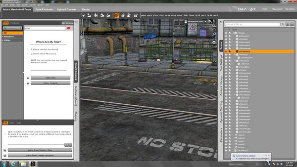

    Here's a street view of mine. The first shows the garbage decal as it is by default, the 2nd screenshot shows I've hidden it and cleaned up the streets.
    1920 x 1080 - 2M
    1920 x 1080 - 2M

    If I understand correctly, the question isn't "can I hide elements of a set?"
    It's "A single element (U2SEProps2) has multiple different items in it. Jean Le Meur would like to be able to turn off SOME, but NOT ALL of the items in that single element (U2SEProps2) , but it does not expand in the scene tab to show the different items. Is there a way this can be done?"
    I ran into this same thing earlier...can the single elements...shown as a cube with no expansion triangle...be drilled into?
    421 x 22 - 12K
