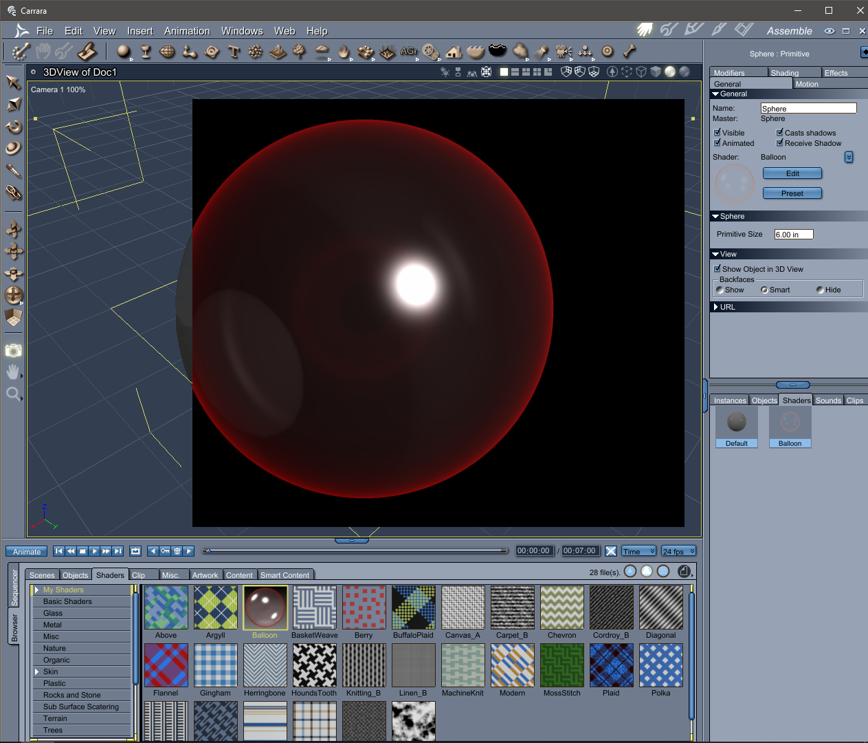

  • Well, I decided to purchase p3do and am waiting for a software key - how long does that take?
  • I'm still waiting...
  • Just arrived - so I'll give it a whirl...

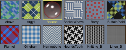

  • Works a treat...
    (Click on detail above for the bigger picture)
  • Persona Non GrataPersona Non Grata Posts: 1,365
    edited July 2019
    ..the only think I would say is that when you use the beautifully iconed shaders by either dragging them to the shaders tab or directly over an object Carrara recalculates the icon for the copied file - WHY???
    BECAUSE - any alterations to the shader need to be updated in the thumbnail - so, the developer decided to just program a sub-routine to do this automatically upon changes to the folder !!!
