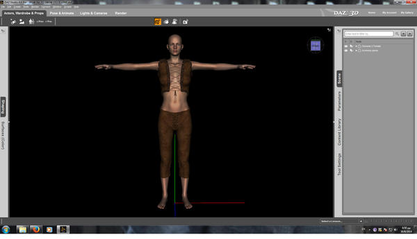

I want to export some characters to Iclone Via 3dxchange, but when i export my character from Daz, the clothes are completely off..
This is the character i want to export, but when the exporting process starts, the shirt goes down on it's own, after i spent many minutes trying to fit it to the character. And then naturally, when i import it in 3dxchange, it comes totally wrong...
Note: The auto-fit tool worked for the pants but it didn't for the shirt, so i did it manually.
So what is the problem here? Why does the shirt come off on it's own when the character is exported?

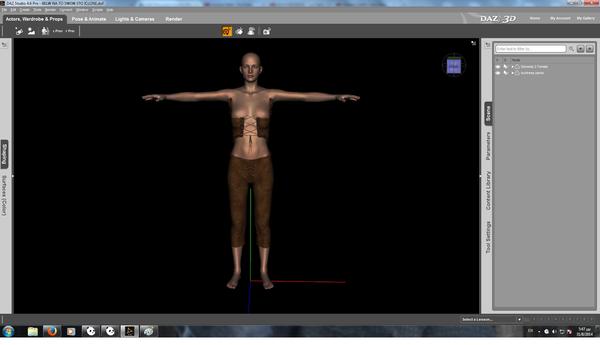

    However, the shirt didn't fit no matter which option i chose in the auto-fit tab (Genesis/Victoria 4/Genesis 2 Male/Unsupported etc). See here what happened when i tried to auto-fit the shirt.
    So i just placed it myself where it was supposed to be and then i just parented it with the chest. No auto-fit at all.
    The model i am using is Genesis 2 (i think it's either Victoria 5 or 6, not sure) and the shirt and pants are for Victoria 3.
    Does that mean that clothes from older generations cannot fit to newer generation models? If so, why did the auto fit in the pants work, and the shirt from the same package didn't?

  • WendyLuvsCatzWendyLuvsCatz Posts: 41,821
    edited August 2014
    It should work if conforming for another figure
    Can you say what the product is?
    Without knowing who it is for hard to get a satisfactory result as all different
    Ah reread
    Fit to genesis first using v3
    Then refit to g2f choosing genesis
