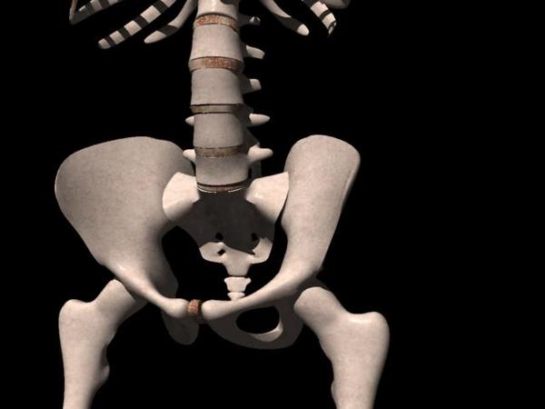

    Well, I'm looking for a skeleton that has more smooth curves (see image of the pelvis) ... and as I mentioned, it's for DazStudio.

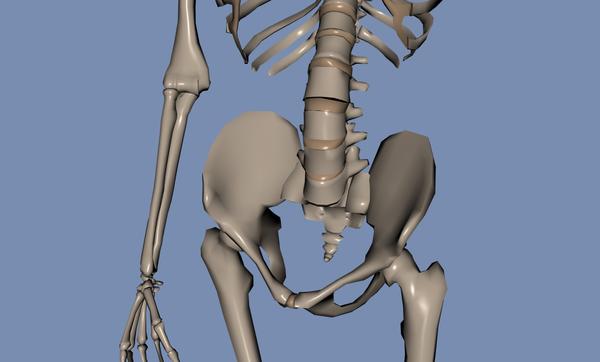

    I have the P4 skeleton but I use carrara and I just apply smoothing.. doesn't DS have this?

    In DAZ Studio, to apply smoothing select the object, then from the menu choose Edit > Object > Geometry > "Convert to Subd". Then the Parameters pane, select the object then if desired you can adjust General > Mesh Resolution > "SubDivision Level" slider more or less.
    HEY! That worked! Well, it made it a whole lot better, anyway! Thanks...
    I'll also take it through PS, and see if I can make it better looking there.
    It's for a comic I'm making. ;-)

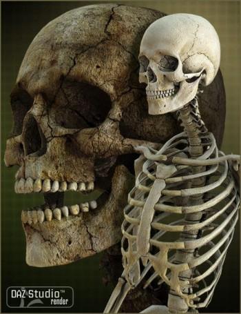

    For the skeleton textures I'd recommend getting the additional 'Victoria and Michael Skeleton Textures' . I found the original textures quite disappointing. Unfortunately the add-on set has been vaulted from the store, but you still find them in few bundles, some currently on great sale prices. The textures have two additional sets, one is a better quality 'default' one, the other a darker grunge one. I'll add the image from product library that shows both.
    You'll find them e.g. in this bundle, they are listed under what's included:
    www.daz3d.com/haunt-starter-bundle
    They should come with this cheaper bundle too, though it does not list them anymore:
    www.daz3d.com/skeleton-dungeon
    My product library still lists them as part of this cheap bundle and the promo images on item page show them, too. You maybe could try that one and get a refund if they aren't in there e.g. to get the larger bundle.
    Still doesn't make sense DAZ kicked them off the store as separate items. Hope they revise their decision some day.
    Edit: I think the promo images of Michael and Victoria 4 Skeleton unfortunately show the add-on textures, though not being in the original product. I remember some confusion and dissappointment about that on forums long ago.
    Edit 2: As it is stated below the textures might be now included with the original skeletons, so I removed the links to the bundles. Take care you don't buy twice if you already should have them or get them through recent download for M4/V4 skeletons (didn't verify that myself).

  • bad4ubad4u Posts: 684
    If that's the case it makes sense they disappeared from store, still DAZ could have made a note on product page about the update then. I know the better textures didn't come with skeletons before, as I remember being disappointed myself when I did a first test and those were far from what was in the promos, so I got the additional textures later with a bundle. Didn't use the skeletons for long time now, so I can't say if they have been updated later to include them.
    I'll update my previous post to reflect that.
