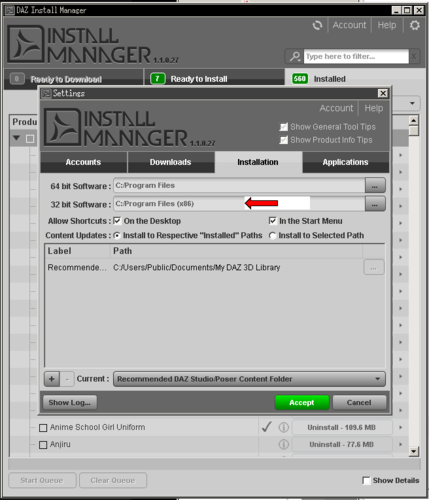

    Everything is in C / Users / Punblic / Documents / My Daz 3D Library
    edited August 2014

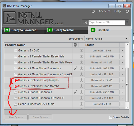

    And I assume the other is correct as well. the "32 bit Software" thing in Daz Install Manager?
    If so, try an uninstall, and then install.
    (edit)
    when you go to put the morph pack back in, it may end up in the "Ready to Install" top-tab, possibly.
