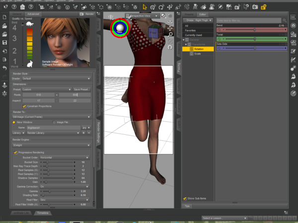

  • Scott LivingstonScott Livingston Posts: 4,352
    In the Scene pane, select the right thigh bone of the dress, and bend it a bit (Posing or Parameters pane). That should get rid of the pokethrough.
    The reason I asked which dress it was is that other dresses might have different solutions...some might have movement morphs to dial, and sometimes the best solution might be to adjust the smoothing and collision modifiers (that method would work fine in this case, too).
